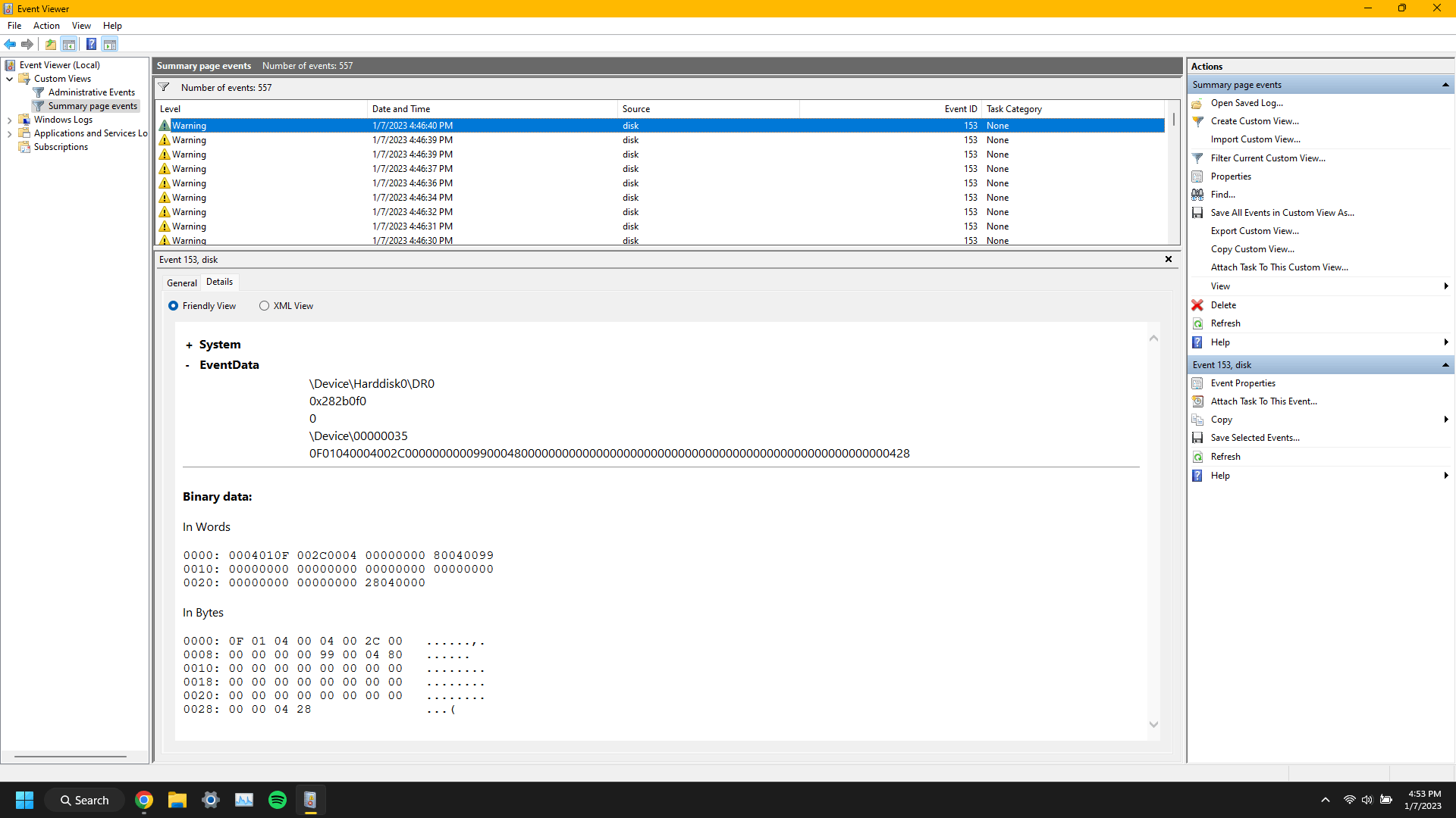

    Event ID 153 / 14 f28362ab-3ed0-4e8f-b833-6912e7184795?upload=true.png
    scaredboy23, Mar 2, 2025
