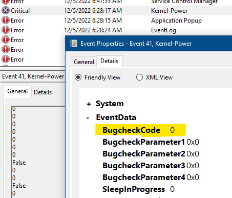

    *37178-7a3afbf0d10a5e91822ad6cf8e0e9f9a.jpg*
    Could be an O/C going south(bad).
    Run a memtest.
    Could be an update that is not settling well with your system. (try rolling back the updates or a system restore to a point before the trouble began).
    Run a "chkdsk /r /f " (no quotes) from a command prompt or with the UI.
    Run a "sfc /scannow" (no quotes and a space between the "c" & "/") from an administrative command prompt.
