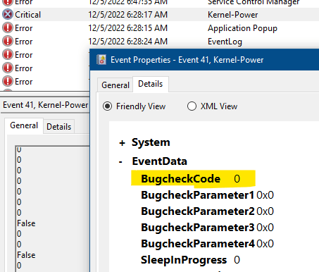

  3. Event ID 56 Application Popup not found error
    • Event ID 41 isn't recorded or the bug check code is zero. This behavior might indicate a power supply problem. If the power to a computer is interrupted, the computer might shut down without generating a Stop error. If it does generate a Stop error, it might not finish writing the error codes to disk. The next time the computer starts, it might not log Event ID 41. Or, if it does, the bug check code is zero. The following conditions might be the cause:
      • In the case of a portable computer, the battery was removed or drained.
      • In the case of a desktop computer, the computer was unplugged or experienced a power outage.
      • The power supply is underpowered or faulty.
    (Src: Event ID 41 The system has rebooted without cleanly shutting down first)
    Event id 41 bug check code 59 92d85795-e2d4-4419-8d48-01bce51b50af?upload=true.png
    So, in all probability, it's the power supply.
    Ramesh Srinivasan, Mar 17, 2024
