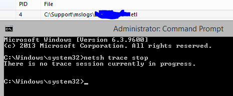

  4. Event Trace Sessions, how to permanently stop UBPM session, stopping it also gives me...
    Netsh trace session cannot be killed
    I have a trace session running, generating high IOPS on C drive on three 2012 R2 servers. It was set by command:
    netsh trace start capture=yes report=yes scenario=netconnection persistent=yes maxsize=1024 tracefile=c:\support\mslogs\%computername%.etl
    and attached to Event to generate log on server failure. When event occurred, command ran.
    Since then, there was a number of server reboots, but because of persistent=yes parameter it was still running. We now do not need that trace running.
    Event Trace Sessions, how to permanently stop UBPM session, stopping it also gives me... fb3ca2b0-0b54-406c-b685-f3549256f731?upload=true.png
    So we deleted task from Scheduled tasks, but trace still is running and cannot be stopped. I tried netsh trace stop, but it says that there is no trace session running - but we see that there is active session, when we delete .etl file it is recreated
    immediately.
    Event Trace Sessions, how to permanently stop UBPM session, stopping it also gives me... 7d468cf7-05b4-4485-8ea9-4ce224d0bf80?upload=true.png
    Does anyone have any idea how to kill this trace session, if it is not visible in netsh?
    Any advise appreciated.
    PokerFace_350, Feb 20, 2022
