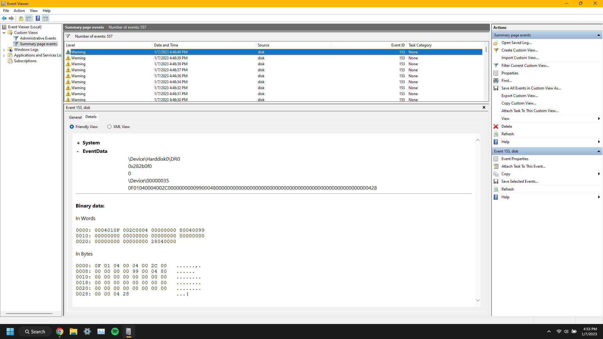

  4. event viewer constant disk warning event 153 followed by BSOD and going into bios after restart
    how to fix event id 153?
    over the last month or so my laptop has been randomly freezing and bsod, i keep getting a disk warning with event id 153 and i've check my ssd and it doesn't seem to have anything wrong with it.
    here is a screenshot of the warning.
    event viewer constant disk warning event 153 followed by BSOD and going into bios after restart f28362ab-3ed0-4e8f-b833-6912e7184795?upload=true.png
    scaredboy23, Oct 14, 2023
