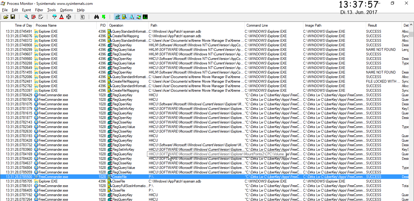

    Hmmm... I don't know and I can't figure out how to replicate or create something similar on my system, I suspect because I don't have the 'Operation' column in Process Explorer. I've never seen that column before, and I can't figure out how to activate it on my Win7 system. How did you get it to display? (Is it perhaps only available in Win10?)
    Do those FreeCommander P:\ line entries have any associated handles if you open handles in the lower pane (Ctrl+H)? When you see this kind of entry after FreeCommander is closed, does a Process Explorer search (Ctrl+F) for 'P:\' find any open handles associated with FreeCommander? If not, then it doesn't seem like deleting/closing the P:\ line entries would be necessary before removing the external USB drive.

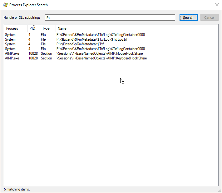

    I haven't previously noticed handles like the AIMP.exe handles shown here (without the drive P\: in the handle Name, and with 'Section' as the handle Type). Do those handles close if you close AIMP?
    At any rate, I'm guessing they are not relevant to the inability to safely remove the external USB drive, as it appears you searched for "P:" rather than "P:\", and those handles were found because they include "P:" in the handle Name (AIMP:MouseHookShare and AIMP:KeyboardHookShare).

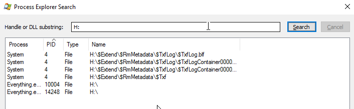

    Without researching it further (which I don't have time or energy to do right now), I'm still not 100% certain what produces the ...$Extend\$RmMetadata\$Txf handles. I previously mentioned from recollection of my research a few years ago that these handles are associated with NTFS journaling, but if I remember correctly, commenters in some forums/blogs thought they might be associated with Windows Indexing or Recycle Bin. My best recollection is that after sifting through everything I could find, I was about 90-95% certain the culprit was/is NTFS journaling.
    I've since forgotten much of what I learned at that time, but this MSDN blog post by Raymond Chen (Jan 1, 2013) seems to explain the relevant basics of NTFS journaling in regard to removing an external USB drive. If I understand it correctly, the journaling is the first of several steps whenever changes are made to a file on an NTFS drive, and "provides file system recoverability by logging ... operations required for any transaction that alters important file system data structures ... before these operations are carried through on the disk" (e.g., before all other steps necessary to complete copying/altering/deleting a file). File data loss/corruption problems can occur if an external USB drive is removed before all the other steps are completed. As you obviously already understand, with write caching enabled, it is possible that the remaining steps may not actually be completed when the OS informs the user that the copying is complete, as the file changes cached in RAM may not yet written to the removable drive (presumably depending on how busy the OS is, data transfer speed, etc.). So their could be data corruption if the drive is unplugged before those steps are completed.

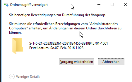

    I can see that this refers to what appears to be a Recycle Bin (S-1-5-21-263......), but any chance you could post an English translation of the first 5 lines?

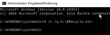

    Ohhh, very interesting!!!
    Did you check what happened to the ...$Extend\$RmMetadata\$Txf handles in Process Explorer after you deleted the $Recycle.bin? ...I'm assuming they must have been closed/gone, but I'm trying to understand if deleting the $Recycle.bin closed the handles. If so, maybe they don't have to do with NTFS journaling, or perhaps NTFS journaling and Recycle Bin interact somehow (???)
