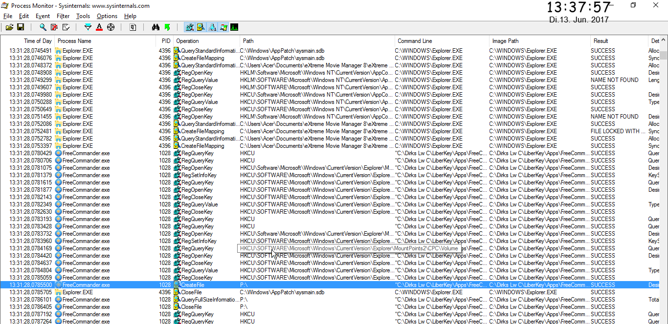

    Hmmm... I don't know and I can't figure out how to replicate or create something similar on my system, I suspect because I don't have the 'Operation' column in Process Explorer. I've never seen that column before, and I can't figure out how to activate it on my Win7 system. How did you get it to display? (Is it perhaps only available in Win10?)
    Do those FreeCommander P:\ line entries have any associated handles if you open handles in the lower pane (Ctrl+H)? When you see this kind of entry after FreeCommander is closed, does a Process Explorer search (Ctrl+F) for 'P:\' find any open handles associated with FreeCommander? If not, then it doesn't seem like deleting/closing the P:\ line entries would be necessary before removing the external USB drive.

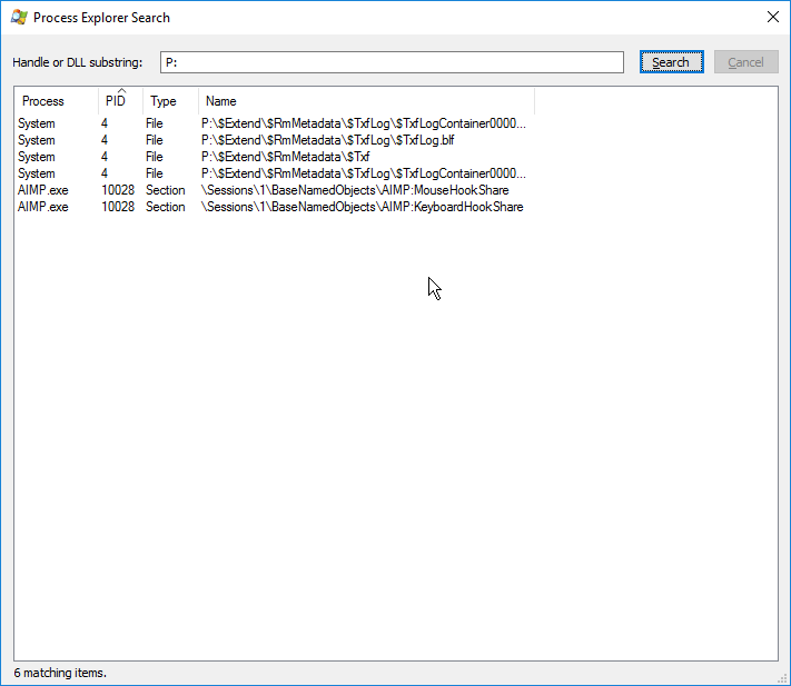

    I haven't previously noticed handles like the AIMP.exe handles shown here (without the drive P\: in the handle Name, and with 'Section' as the handle Type). Do those handles close if you close AIMP?
    At any rate, I'm guessing they are not relevant to the inability to safely remove the external USB drive, as it appears you searched for "P:" rather than "P:\", and those handles were found because they include "P:" in the handle Name (AIMP:MouseHookShare and AIMP:KeyboardHookShare).
    Without researching it further (which I don't have time or energy to do right now), I'm still not 100% certain what produces the ...$Extend\$RmMetadata\$Txf handles. I previously mentioned from recollection of my research a few years ago that these handles are associated with NTFS journaling, but if I remember correctly, commenters in some forums/blogs thought they might be associated with Windows Indexing or Recycle Bin. My best recollection is that after sifting through everything I could find, I was about 90-95% certain the culprit was/is NTFS journaling.

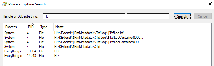

    This reminds me that when I previously researched this, there was also some discussion in the Everything Search forum about whether NTFS indexing by Everything Search might be preventing external USB drive removal (and maybe something about whether Everything made use of the ...$Extend\$RmMetadata\$Txf handles ???). I don't recall the issues clearly right now, but I think there were some suggestions about how to tweak the Everything NTFS Index settings that seemed to make sense. ...But IIRC correctly I tried the suggested remedies without success.

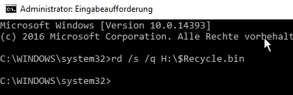

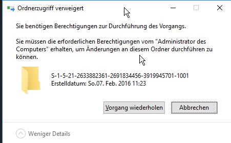

    I can see that this refers to what appears to be a Recycle Bin (S-1-5-21-263......), but any chance you could post an English translation of the first 5 lines?
    Ohhh, very interesting!!!
    Did you check what happened to the ...$Extend\$RmMetadata\$Txf handles in Process Explorer after you deleted the $Recycle.bin? ...I'm assuming they must have been closed/gone, but I'm trying to understand if deleting the $Recycle.bin closed the handles. If so, maybe they don't have to do with NTFS journaling, or perhaps NTFS journaling and Recycle Bin interact somehow (???)
