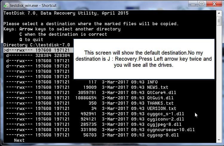

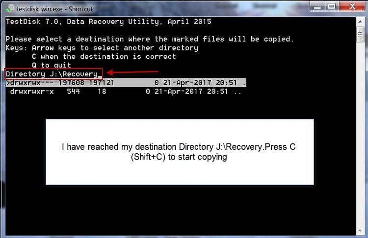

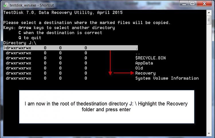

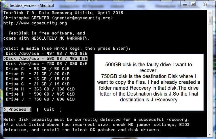

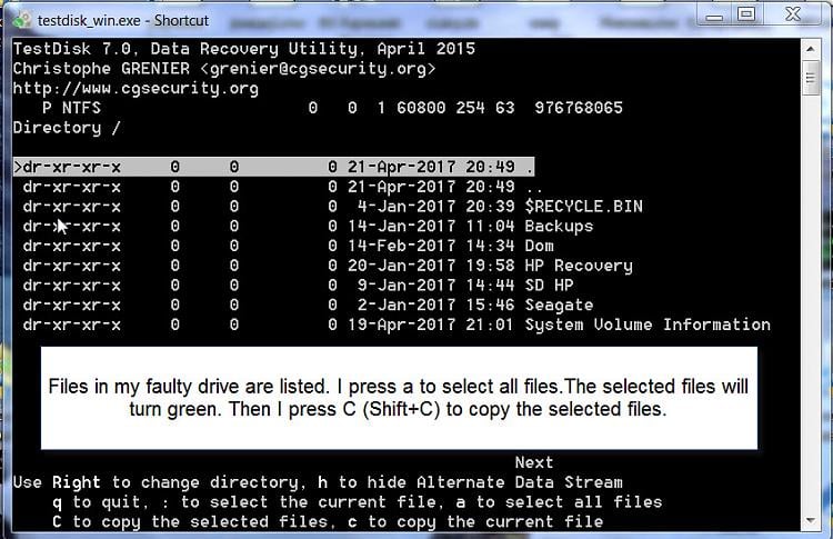

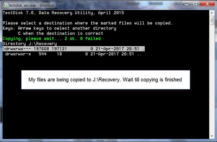

  3. jumanji Win User
    External Hard Drive (WD Elements) is visible in PW but not in explorer

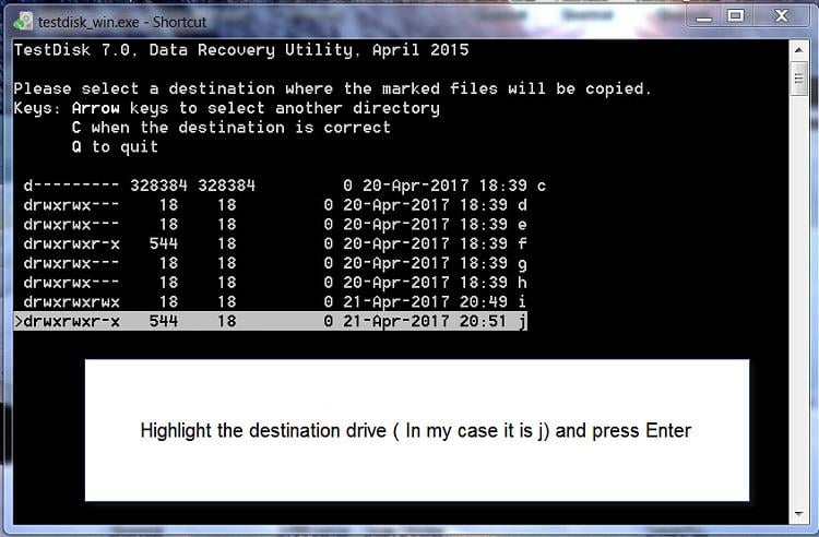

    The process of reaching the destination is vividly explained here Copying files listed by TestDisk during Recovery : My post #28 here https://www.sevenforums.com/hardware...ml#post2395385 (already mentioned in my post #5 )
    I repeat it here
    External harddisks not showing up on file explorer but visible in system tray. Only hard... 223d1492794366t-external-hard-drive-wd-elements-visible-pw-but-not-explorer-a21-04-2017-21-43-17.jpg
    Here I am omitting the screenshots leading to the listing of files in the faulty drive since you already know how to get there.
    External harddisks not showing up on file explorer but visible in system tray. Only hard... 224d1492794366t-external-hard-drive-wd-elements-visible-pw-but-not-explorer-b21-04-2017-21-51-05.jpg
    External harddisks not showing up on file explorer but visible in system tray. Only hard... 225d1492794907t-external-hard-drive-wd-elements-visible-pw-but-not-explorer-c21-04-2017-21-58-50.jpg
    External harddisks not showing up on file explorer but visible in system tray. Only hard... 226d1492794366t-external-hard-drive-wd-elements-visible-pw-but-not-explorer-d21-04-2017-22-05-50.jpg
    External harddisks not showing up on file explorer but visible in system tray. Only hard... 227d1492794366t-external-hard-drive-wd-elements-visible-pw-but-not-explorer-e21-04-2017-22-09-36.jpg
    External harddisks not showing up on file explorer but visible in system tray. Only hard... 228d1492794399t-external-hard-drive-wd-elements-visible-pw-but-not-explorer-f21-04-2017-22-13-57.jpg
    External harddisks not showing up on file explorer but visible in system tray. Only hard... 229d1492794934t-external-hard-drive-wd-elements-visible-pw-but-not-explorer-g21-04-2017-22-19-36.jpg
    jumanji, Feb 9, 2023
