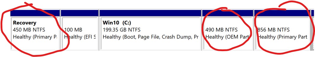

    I have upgraded Windows 10 multiple times from previous builds to current 1903. I see multiple hidden partitions have been created over the upgrades, and read that most of these are Recovery partitions.
    I know the first 450 MB one is the one created during the first install. Then the 490 MB one (second from the last) was created from the upgrade to 1803. The last 856 MB one was created from the upgrade to 1809 if I remember correctly (I guess so). When I recently upgraded to 1903, no extra partition was added. I guess one of the three (or the last two) was used.
    Among these 3 recovery partitions, how do I know which recovery partition is used for the current 1903 version? I wish to remove the two previous recovery partitions.
    Thanks. Extra partitions a963f3bd-1bbe-4350-b0b1-714d208d4c0a?upload=true.jpg

    I appreciate your time and efforts in troubleshooting. Please note that once you install Windows, you will have some extra partitions than what you can see. These partitions are usually system reserved and may not appear in File Explorer. You will
    have an extra partition called recovery partition if the Windows is installed by OEM of the computer. Here is some information on types of the partitions:
    1. Hard drives and partitions.
    2. UEFI/GPT-based hard drive partitions.
    As you mentioned that you deleted all the partitions, you will have a new partition named as unallocated space. It is not allocated space, you will need to select this partition and then click on New to create a new partition. Once a new partition
    (primary) is created, select the partition and then install Windows on it. Here is some information to help you with installation:
