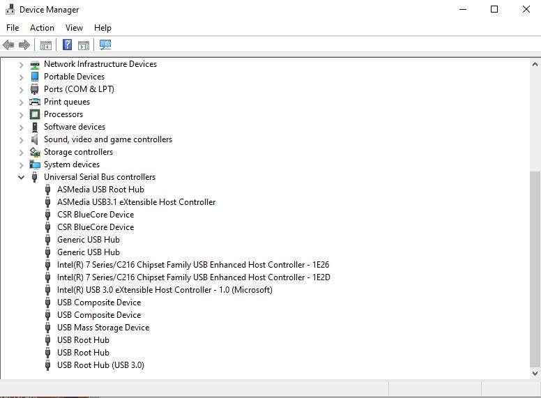

    Dear Community
    Please refer the attachment
    I have recently purchased Asmedia chipset based expansion card PCIe x4
    https://www.amazon.sg/gp/product/B07X92394W/ref=ppx_yo_dt_b_asin_title_o00_s00?ie=UTF8&psc=1
    However, it didnt reach the performance it should be. Less than 20mb/s transfer rate when I use with Sandisk ULtra USB Type C 3.1 Flash Drive
    I have yet to try my other new USB 3.1 Gen 2 devices
    I wonder if there is any wrong with drivers installed? Any missing file I should have installed?
    Asmedia driver installed so far is: ASMedia_xHCI_Host_Controller_Driver_v1.16.43.1
    Driver from CD Rom is seem outdated
    Hope anyone is able to help
    Thanks
    Gary
    Failed to perform - PCI Express 4X to USB 3.1 Gen 2 10 Gbps 2-Port Type C Expansion Card... 06777e7b-72b9-4683-a998-bfa2e88b142e?upload=true.jpg
    GaryAng2020, Apr 16, 2020

    What motherboard/chipset are you using? As per your expansion card's specs, "the maximum throughput of this card is limited by the bus interface. If used with PCI Express Gen 1.0 enabled computers,
    the max throughput is 2.5 Gbps. If used with PCI Express Gen 2.0 enabled computers, the max throughput is 5 Gbps."
    cioredulla, Apr 16, 2020
