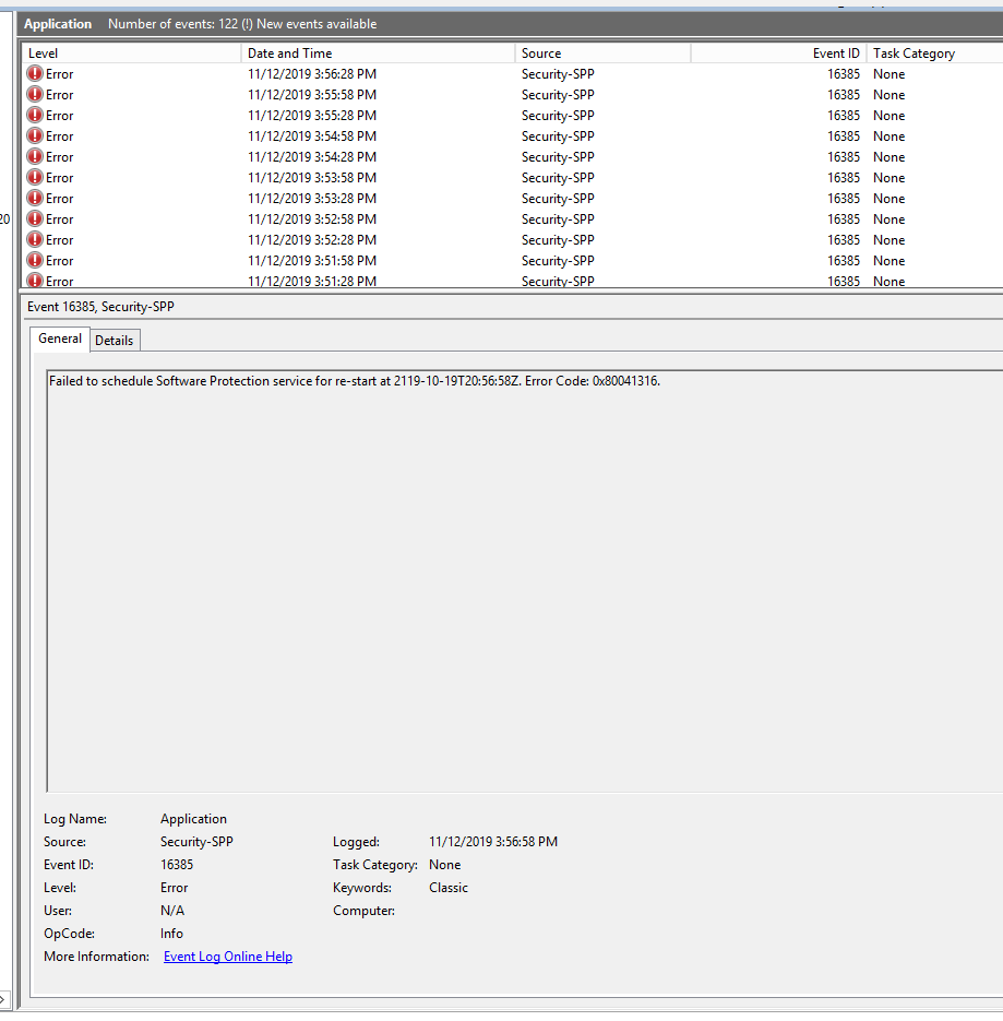

  1. Failed to schedule Software Protection service for re-start at 2119-10-19T18:07:58Z. Error...
    our Windows Server 2012 Essentials is getting evenvwr poluted with the error message bellow and attached every 30 seconds. I've done a lot of research but nothing worked so far, this is what I tried:
    • Check the NETWORK SERVICE permissions on C:\Windows\System32\Tasks\Microsoft\Windows (it has FULL CONTROL)
    • checked services and its dependencies and ensure they are running and have startup mode = automatic
    • checked windows license with slmgr /ato
    • started and stopped sppsvc service with net stop sppsvc/ net start sppsvc
    This is our domain controler so I can't reinstall Windows - Any help please
    Failed to schedule Software Protection service for re-start at 2119-10-19T18:07:58Z. Error... 0eeb67b8-af29-4600-bb4d-e312a1d14ee0?upload=true.png Log Name: Application
    Source: Microsoft-Windows-Security-SPP
    Date: 11/12/2019 1:07:58 PM
    Event ID: 16385
    Task Category: None
    Level: Error
    Keywords: Classic
    User: N/A
    Computer: DC20001811
    Description:
    Failed to schedule Software Protection service for re-start at 2119-10-19T18:07:58Z. Error Code: 0x80041316.
