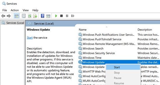

    Ran Setupdiag. Results highlighted Operation failed: Enable Page File in SafeOS. Error: 0x8007023E[gle=0x000000b7]
    occurring right at the end of the installation (last reboot).
    Researched that on the internet and lots of possibilities. Most suggested fixes were pretty complicated and did not seem to work for others. Video card driver seemed most likely but I had the latest AMD driver even though it was 2015 was MS certified.
    One optional update was for an "alcor USB driver" which I had never installed since everything seemed to be working fine. I updated that driver.
    Then I ran across an easy to implement series of steps (that I felt would not corrupt my current install.
    These steps were:
    1. Go to the Windows search bar and type services.
    2. Double-click on the Services app and scroll down to Windows Update.
    3. If the service is already running, right-click on it and select Stop. Then restart it.
    4. If the service is disabled, right-click on it and select Start.
    5. Additionally, make sure the Background Intelligent Transfer Service and Cryptographic Service are running.
    I made sure these 3 services were running and then restarted each of them.
    Rebooted the computer and ran the Windows 10 update assistant again. This time the update completed successfully and I am now running 21H1. I do not know if it was the USB driver upgrade or the services resets that corrected the problem but each were painless to implement.
