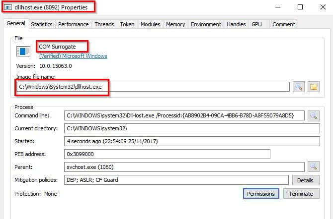

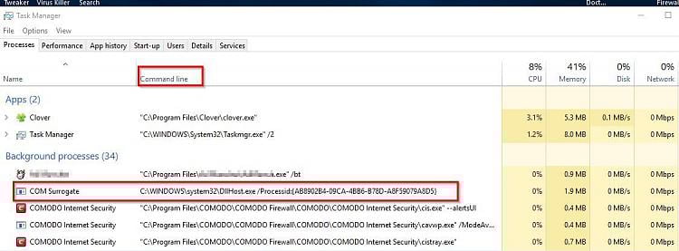

    If you enable command line view in task manager then you might see if dllhost.exe is running like this:
    File can't be deleted / modified,, its open in COM surrogate 165547d1511651483t-file-open-com-surrogate-dllhost_exe-properties.jpg
    File can't be deleted / modified,, its open in COM surrogate 165548d1511651505t-file-open-com-surrogate-dllhost_exe.jpg
    If that's the case then it's likely that you have one or more folders containing one or more corrupt images which explorer cannot create thumbnails for or else the thumbnails are corrupted. this can also happen especially with folders that contain video files where thumbnails are created.
    The solution is tricky. Either scan for and delete corrupt image files and videos (if you know how to do it) or else move all suspect folders to an external drive and disconnect it. Reboot and test. If the problem has gone you would move folders back one at a time testing after each move.
    Callender, Jun 10, 2023
