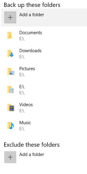

    Anyway, in File History, I select the various libraries in E:/, as well as E:/ itself, for backup to the external drive F:/.
    File History can't find folders in libraries for a restore W10 206374d1538413893t-w10-file-history-not-backing-up-selected-folders-folders.jpg

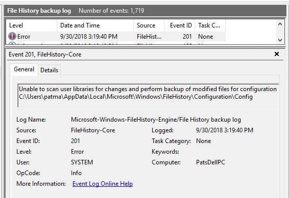

    But it only seems happy with the oddly defined Docs library, won't find the other selected folders... log error:
    File History can't find folders in libraries for a restore W10 206375d1538413997t-w10-file-history-not-backing-up-selected-folders-log.jpg

    Any clues?
    patmat2350, Sep 7, 2024
