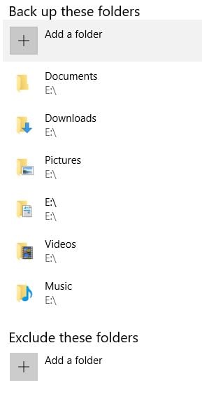

    Been having trouble with my WD external drive backup s/w, it keeps losing track of its external drive, so I decided to simply try using W10 File History to manage things.
    First, I have installed a SSD and migrated my OS there (as C:/), then formatted and set up all libraries on the old 1TB HDD (now E:/)... or so I thought. Don't ask me now exactly what I did, but the definition for the new libraries on E:/ is suspect. E:/ (root) is identifed as the Docs library, with another Docs library inside it, oy.
    Shows appearance under This PC:
    File History can't find folders in libraries for a restore W10 206371d1538413483t-w10-file-history-not-backing-up-selected-folders-newdirectories1.jpg
    Shows appearance under the E:/ HDD:
    File History can't find folders in libraries for a restore W10 206372d1538413483t-w10-file-history-not-backing-up-selected-folders-newdirectories2.jpg
    Anyway, in File History, I select the various libraries in E:/, as well as E:/ itself, for backup to the external drive F:/.
    File History can't find folders in libraries for a restore W10 206374d1538413893t-w10-file-history-not-backing-up-selected-folders-folders.jpg

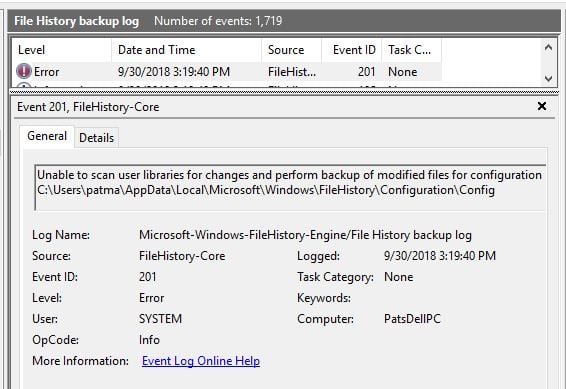

    But it only seems happy with the oddly defined Docs library, won't find the other selected folders... log error:
    File History can't find folders in libraries for a restore W10 206375d1538413997t-w10-file-history-not-backing-up-selected-folders-log.jpg

    BTW, all these un-backed folders are accessible through any other means.
    I see the config files, don't know what do do with them, inside:
    C:\Users\patma\AppData\Local\Microsoft\Windows\FileHistory\Configuration\Config
    Any clues?
