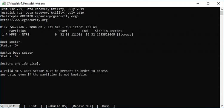

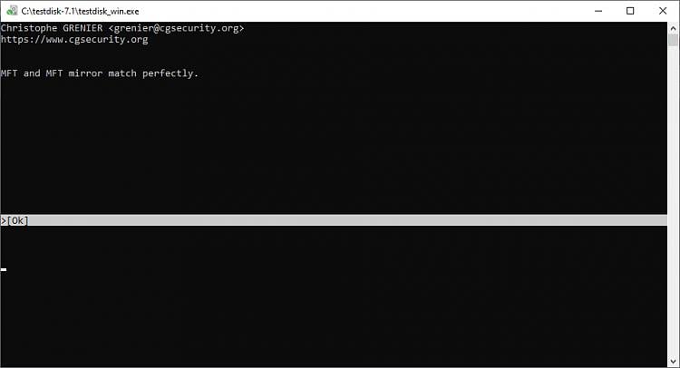

    Thank you for your detailed response! I will follow the steps within the next 24 hours and report back with my findings, thank you! - - - Updated - - - @jumanji Here's testdisk_win.exe with Boot results, showing OK/OK:
    File System says "NTFS" in File Explorer and "RAW" in Admin Command Prompt 359075d1644178584t-file-system-corruption-external-ssd-ntfs-raw-13-t5-testdisk-boot.jpg
    Here's testdisk_win.exe with Rebuild MFT results, MFT and MFT mirror match perfectly:
    File System says "NTFS" in File Explorer and "RAW" in Admin Command Prompt 359076d1644178746t-file-system-corruption-external-ssd-ntfs-raw-13-t5-testdisk-rebuild-mft.jpg

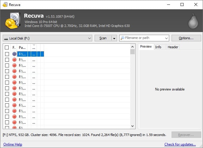

    I want to be honest and tell you the following: - testdisk_win.exe issuing the List command only showed 2 items. - Prior to contacting you, I had run a Scan using Recuva, it showed 2,264 file(s). Here's that Scan with Recuva, showing 2,264 file(s):
    File System says "NTFS" in File Explorer and "RAW" in Admin Command Prompt 359077d1644179196t-file-system-corruption-external-ssd-ntfs-raw-10-t5-recuva-scan.jpg
    How come Recuva finds 2,264 file(s) when testdisk_win.exe shows only 2 items? Do you still recommend proceeding with chkdsk? Thanks again @jumanji, very helpful!
