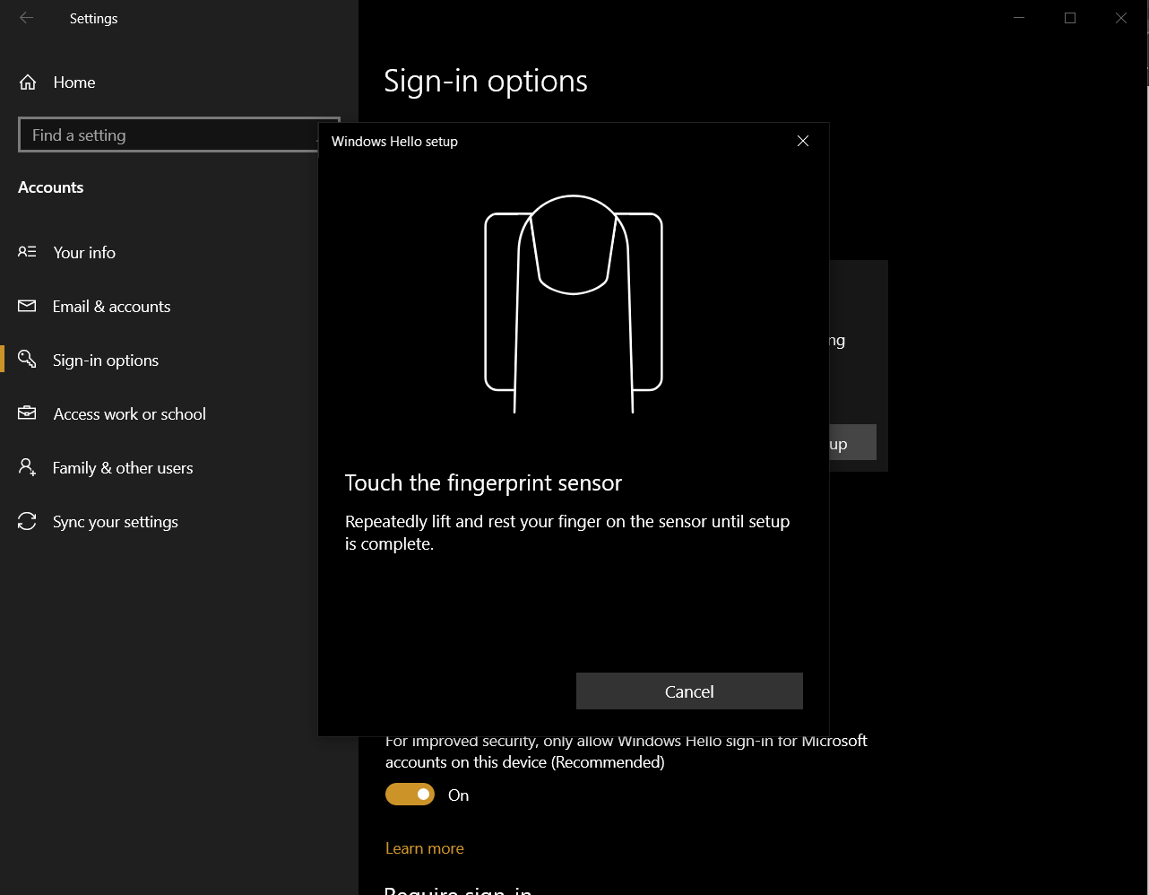

    Is fingerprint setup broken after 2004 update? I clean installed Windows 10 build 19041 this Saturday but when I tried to setup fingerprint, it is stuck on "Touch the fingerprint scanner" screen. Does anyone know the solution? Fingerprint Issue d645159c-93fa-4ebb-9671-8364a8a9e4ea?upload=true.png

  4. Fingerprint Issue
    Windows Hello Fingerprint issue
    Hi Nikhar,
    Thanks for the reply.
    Yesterday I had a chat discussion with one of the Microsoft tech agents. After much troubleshooting and hit and try, some issues got fixed.
    I use HP Client Security for fingerprint login. There I also created 'spare key' which was preventing Windows to show fingerprint login option. When I removed spare key option, I got back the fingerprint login option for me.
    Thanks & regards,
    Rajesh Pathak
    RajeshfromIndia, Sep 10, 2020
