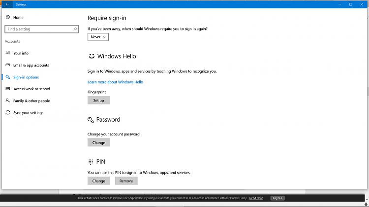

    As you have mentioned that you are able to use the Fingerprint scanner on websites, I would suggest you to refer the steps mentioned below and see if that helps:
    1. On the login screen, click on Sign-in options.
    2. Click on the Fingerprint icon, scan the Fingerprint, and see if you are able to sign in.
    Refer the screenshot below:
    Fingerprint not allowing access in Windows Hello fc087693-5104-47d8-960f-4d6097885918?upload=true.jpg
    If the issue persists, try removing the Fingerprint and add it again. Refer the steps mentioned below:
    1. Press Windows key + I, to open
      Settings
    2. Click on Accounts and click on
      Sign-in options
      on the left pane.
    3. Now, click on Windows Hello Fingerprint and click on
      Remove.
    4. Follow the on-screen instructions to remove the Fingerprint.
    5. Once done, click on Set up and follow the on-screen instructions to add the Fingerprint.
    Let us know how it goes.
