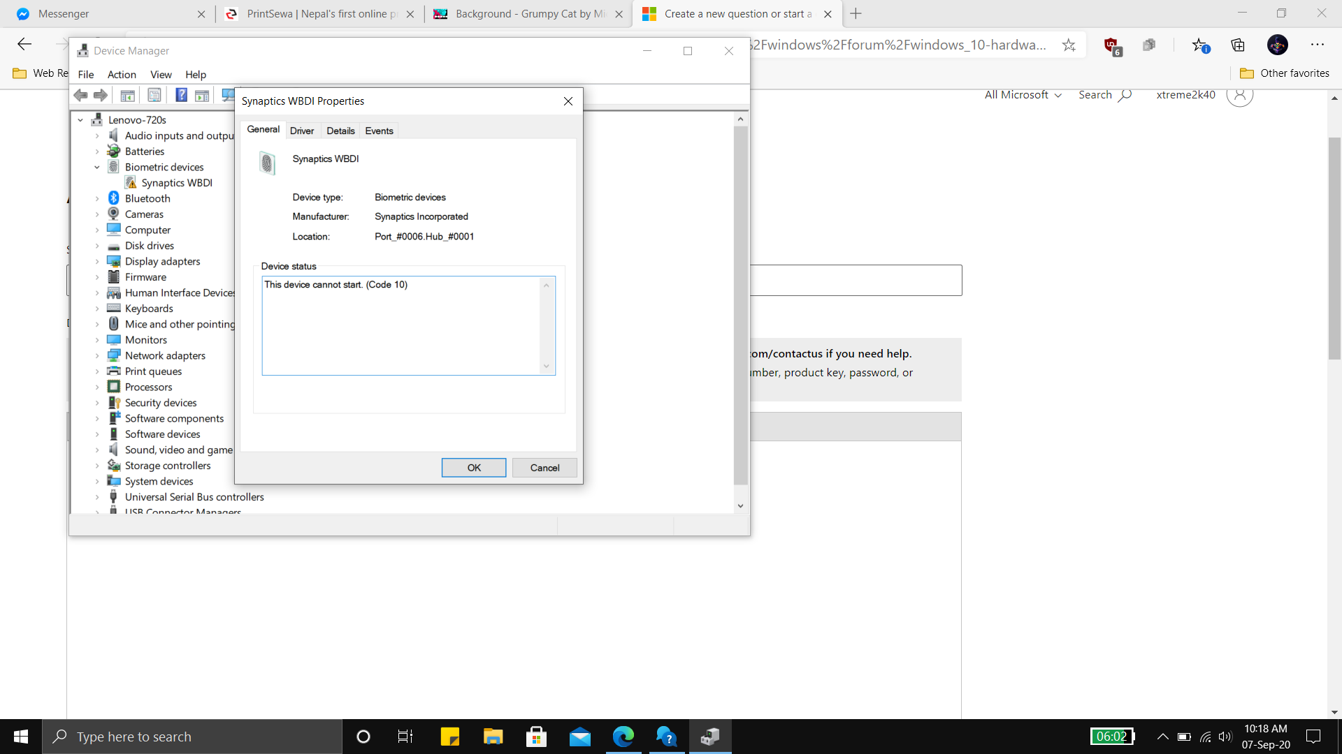

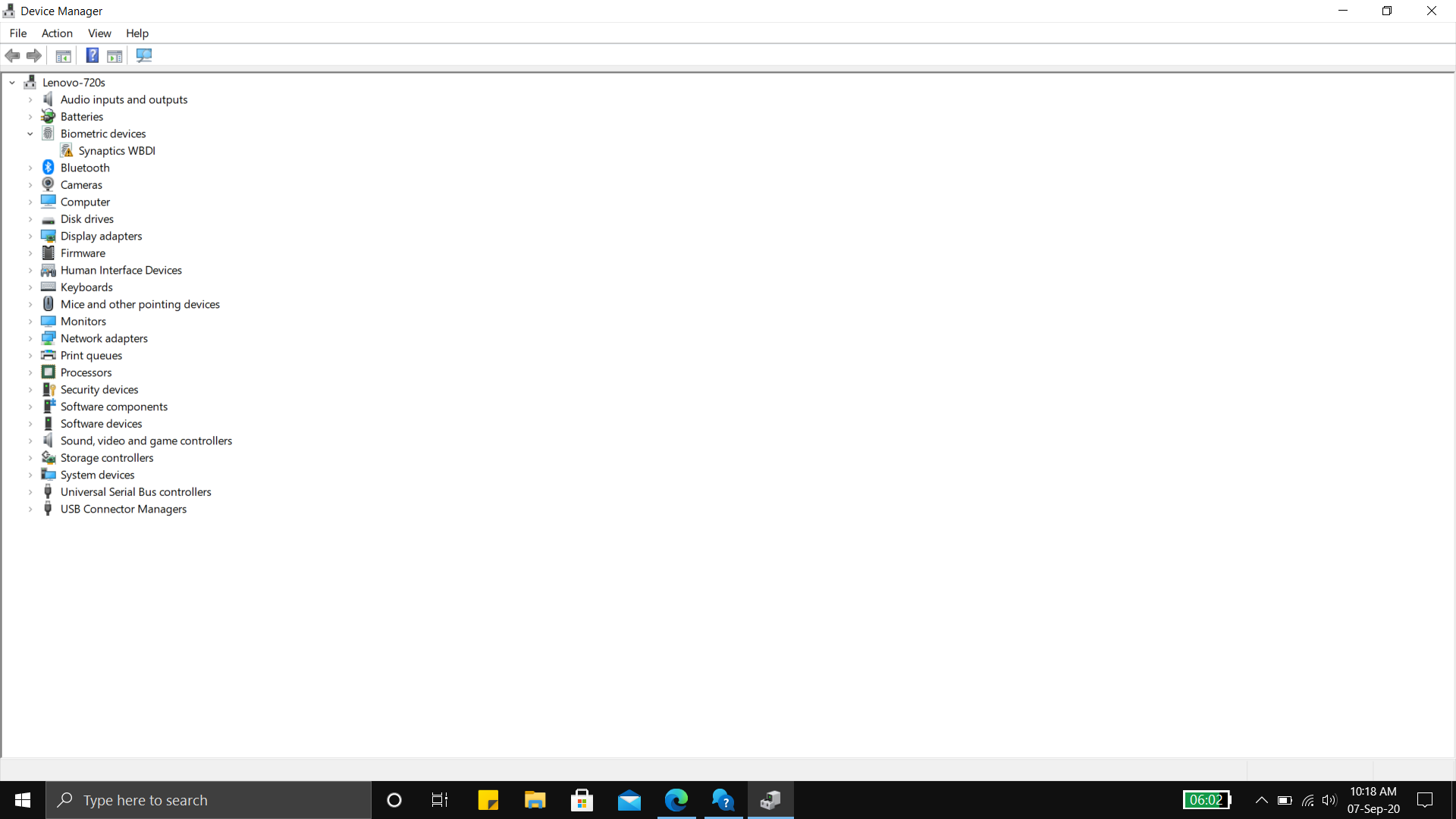

  1. Fingerprint Reader not working in Lenovo
    Here are all the images
    Fingerprint Reader not working in Lenovo b2e88996-acbe-4152-bf58-a153015274fb?upload=true.png
    Fingerprint Reader not working in Lenovo c23bb1e5-29ea-42e2-a21c-2aff89bc560e?upload=true.png
    Fingerprint Reader not working in Lenovo f1b16bc5-ba76-46b6-afaf-674c7420b486?upload=true.png
    xtreme2k40, Sep 7, 2020
