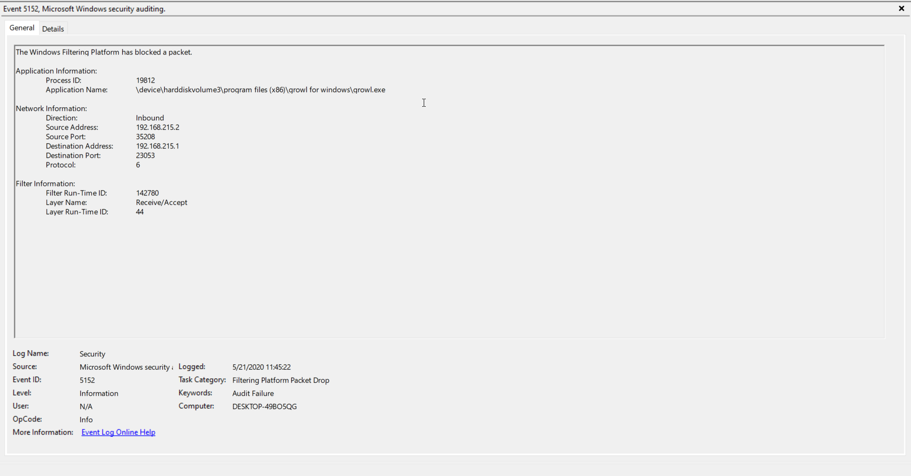

    However when I try to access the host from the VM, the packets are being dropped:
    Firewall blocking access from Hyper-V VM to host over Internal network even though there is... 545039e0-2ddf-4928-aee8-e7b13793caca?upload=true.png
    I've looked at the WFP filters and it's being dropped by this filter even though there is a filter above it which represents the rule:

    The odd thing is that I can access 192.168.50.81 which is the IP address of the Ethernet connection of the host but not the actual IP address of the virtual network adapter i.e. 192.168.215.1.
    Any thoughts about what is blocking the access to the host IP address in the virtual network and how to fix it?
