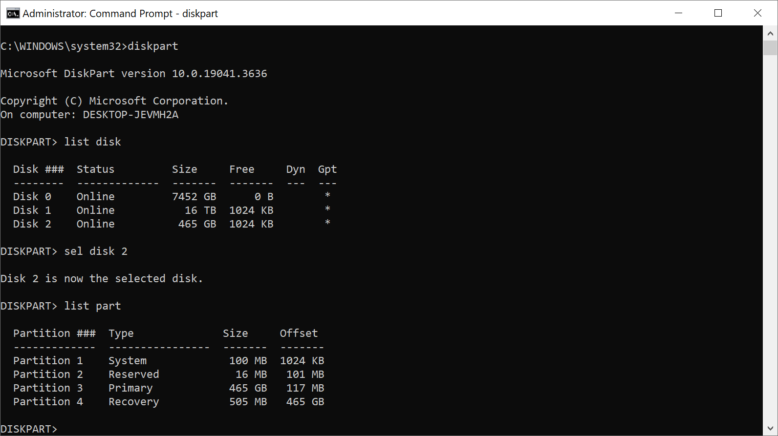

    1. Run diskpart.
    2. Run list disk to get a list of all hard disks connected to the computer.
    3. To select the operating system disk, run the command sel disk <OS disk index>. Replace >OS disk index" with the harddisk value.
    4. List all partitions by running list part. Check for the primary partition there. It is usually the largest.
    5. Select the (primary) operating system partition with the command sel part <OS partition index>.
    6. Run shrink desired=250 minimum=250. This shrinks the operating system partition by 250 MB.
    7. Run sel part <WinRE partition index> to select the recovery partition. Use the partition number that you got when you ran the first command at the top.
    8. Delete the partition by running delete partition override.
