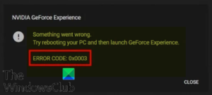

Discus and support Fix NVIDIA GeForce Experience error 0x0003 on Windows 10 in Windows 10 News to solve the problem; [ATTACH]If you’re encountering NVIDIA GeForce Experience error 0x0003 on your Windows computer when you try launching the app, then this post is... Discussion in 'Windows 10 News' started by WinClub, Aug 20, 2020.

  4. Fix NVIDIA GeForce Experience error 0x0003 on Windows 10
    Nvidia GeForce experience not working
    Please try these steps and check after each step. If these don't work, let me know. I will provide further troubleshooting steps.
    A. Windows Key+R > Type services.msc and Enter to open Services Window
    Select any service and press n to reach to services starting with n
    There may be more than one nVidia services. Select one and double click and set the Type to Automatic and also make sure to start the service.
    Do this for all nVidia services.
    B. Uninstall nVidia GeForce and download it from below and reinstall again
    https://www.nvidia.com/en-us/geforce/geforce-ex...
    There are two other actions which you can undertake
    1. Restore from a system restore point to a point when things were working fine
    https://support.microsoft.com/en-us/help/12415/...
    2. If the issue has been caused due to recent Windows update - I would suggest that you uninstall the latest KB update and hide it so that it doesn't install it automatically and wait for new update to come which will be installed automatically.
    To know which update got installed
    Windows Key+i to invoke Settings > Update & Security > Click View installed update history. These KBs should be from the below list. Don't uninstall any other KB
    For 1809 -
    https://support.microsoft.com/en-us/help/4464619
    For 1803 -
    https://support.microsoft.com/en-us/help/4099479
    Make note of KB and uninstall and block it.
    Uninstall
    Windows Key + R > Type: appwiz.cpl > Enter > Click View installed updates > Select the required updates, right click, uninstall.
    Block
    Microsoft has provided a tool Show/Hide Updates tool to block the update
    Download the tool from below link
    http://download.microsoft.com/download/f/2/2/f2...
    When you run this troubleshooter, it will search for available updates and list them
    Select the update which you want to hide. Click Next and follow on-screen directions
