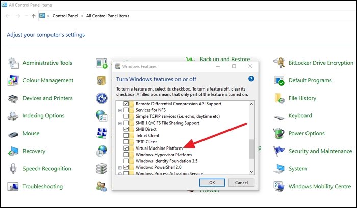

    1] Install Virtual Machine
    Fix WslRegisterDistribution failed with error 0x80070032 Enable-Virtual-Machine-Platform.jpg
    The virtual machine has become a necessity for the WSL version. If your computer supports it, you need to install it using Windows Features.
    • Press the Start button and type Turn Windows Features.
    • Click on the application when it appears in the list
    • Check the box next to Virtual Machine Platform, and click on the Ok button
    Once the feature is installed, try to upgrade or reinstall, and it should work now.
