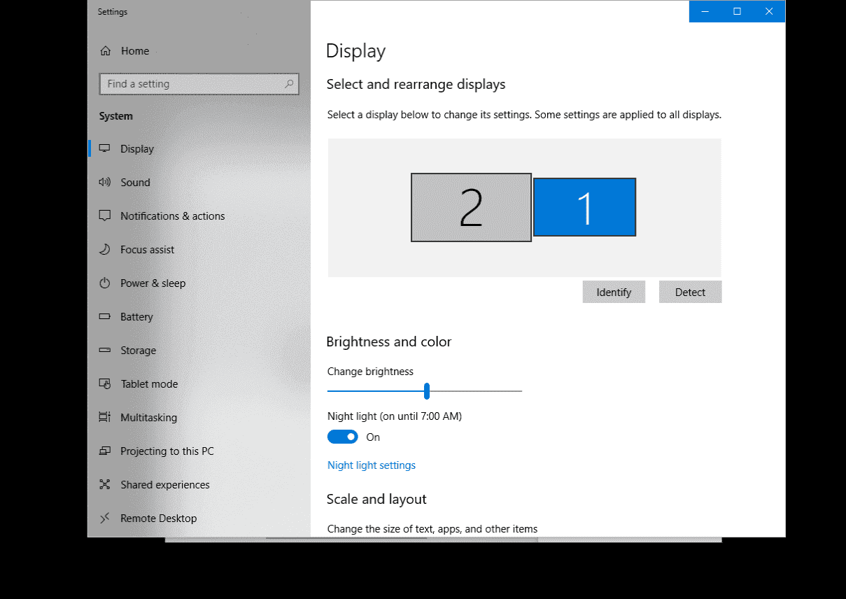

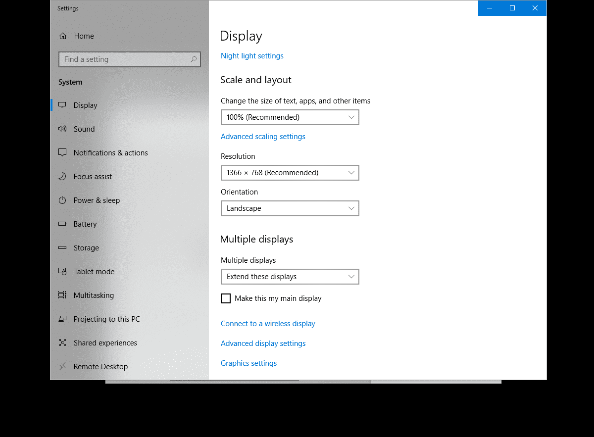

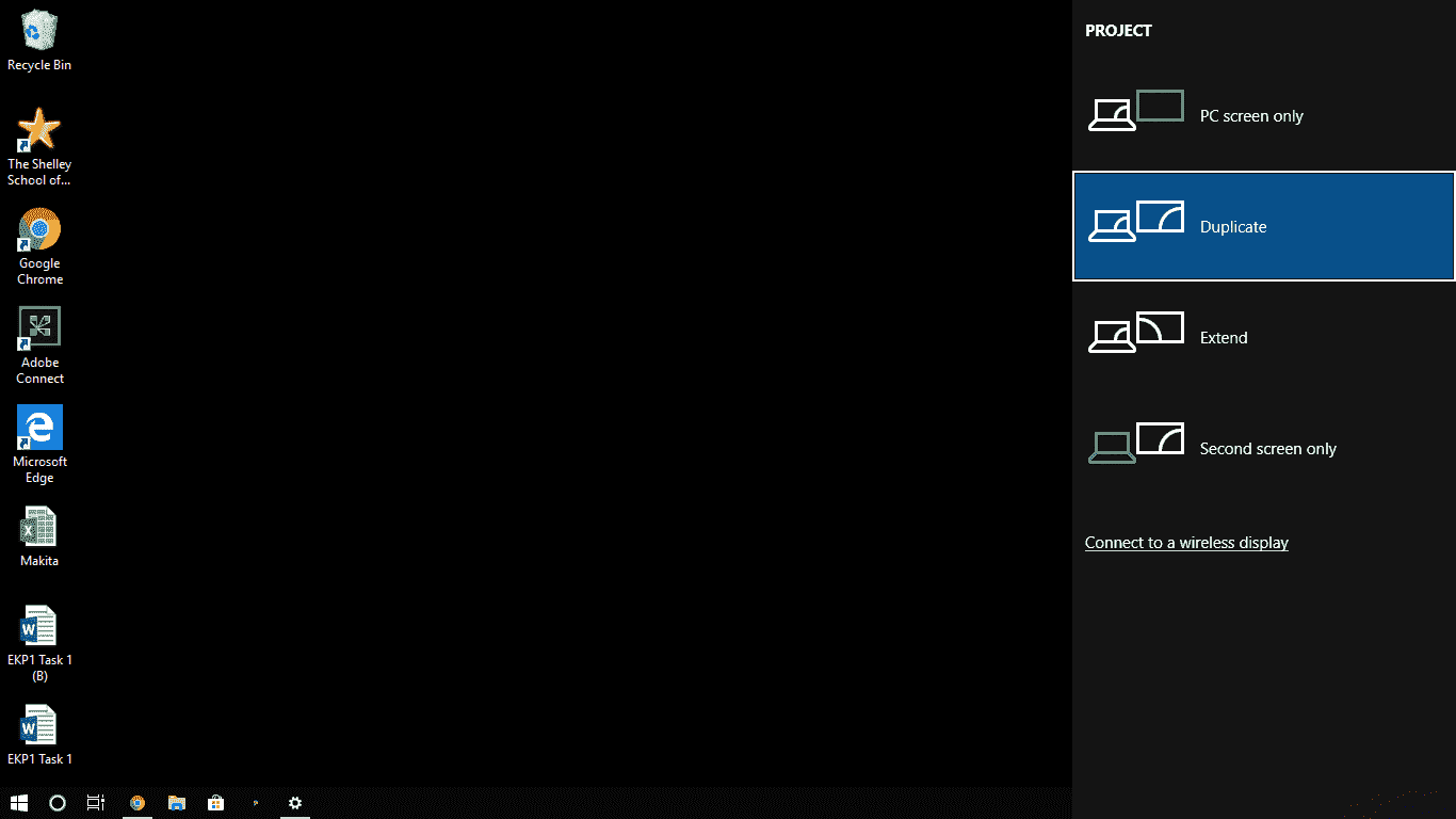

    So prior to the July (ish) update you could hit detect and then it would prompt you to try anyway if monitor is not found. now you hit detect and just nothing happens, sometimes you can get the monitor not found but no continue anyway option. I found an Odd work around. hit fn+f4 bring up the "Project" side window with the 4 second screen options pc only, duplicate, extend, second screen only.
    click on the extend screen and this will turn on the second screen options in the display settings.
    open the display settings then select screen two and select make this my main display.
    (note: when playing with these setting you will most likely at one point or another loose the display settings window to some lost virtual second display simply hold the fn button and press the f4 3 times. this will toggle the display back to the duplicate screen option then select extend screen again switch to screen two in the screen position box and then click make this my main display again)
    I was able to use this with Chrome-cast to set an extended desktop to a tv and adjust the resolution better then using an hdmi cable. had audio as well. there was a little lag but it still worked fairly well. Next step is to try setting up a VPN and Chrome-casting through that to see if I can reduce the lag.
    (FIXED) Found a solution to missing fake/ghost/virtual extended screen problem with windows... ca660bba-8fad-4b73-b5e9-88d07f05e635?upload=true.png (FIXED) Found a solution to missing fake/ghost/virtual extended screen problem with windows... be01f72d-73f2-4566-8df5-a6ae5ec610e1?upload=true.png (FIXED) Found a solution to missing fake/ghost/virtual extended screen problem with windows... 370e9f65-8541-422b-b362-2e696a271e52?upload=true.png
