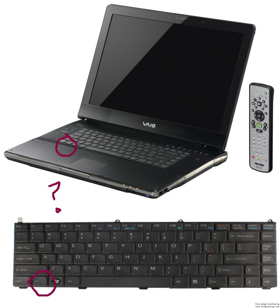

    My boss has a Sony Vaio VGN-AR190G, it seems like FN lock is on, because when he types certain letters that have numbers when pushed with the function key, it types numbers instead of letters. I do not even see a function lock key on this keyboard. I'm not really sure what to do. I've tried googling the issue but haven't come up with a solution. There was a wireless keyboard plugged into the laptop for awhile, I checked that one for a FN lock key and it doesn't have one either.

  4. digibucc Win User
    Fn-lock not working Solution
    Laptop FN Lock?
    no exist? it's in all the screenshots.
    that is what fn does, num lock turns the number pad on or off yes - but it only matters for a dedicated number pad. those are normally arrows when turned off.
