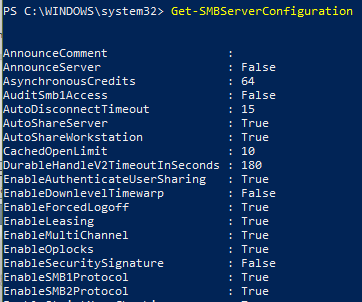

    I am trying to share a folder on a LAPTOP. I have other a number of other systems that have folders Shared and they work fine, but with this one I get the error "LAPTOP is not accessible ..... Access is denied." when I try to access it from a different Win10 system. So I went thru the entire "How to Share Files and Folders Over a Network in Windows 10" tutorial step by step. File and Print Sharing is enabled, SMB1.0 client & server are running, and Everyone has Full Access to the Share. Still get the error. I have tried it with the Network Public and Private, with the same result. Any suggestions ? Microsoft Windows 10 Home Version 10.0.19042 Build 19042

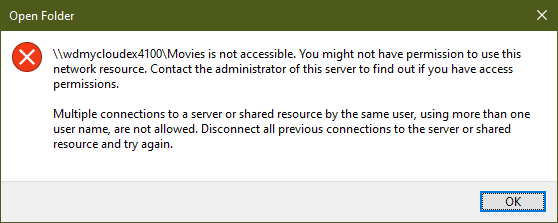

    I believe this is related to the Windows 10 2004 update. Since the upgrade, I can no longer access credential protected folders on my NAS
    I can access the NAS itself. I can get a list of folders using file explorer just fine. Win+R > \\wdmycloudex4100 (ignore the name I kept it the same after an upgrade for convenience) no problem.
    I can access Public folders on the NAS fine. However, when I try to access my previously accessible user credential folders (ones that require a user id & password that is setup on the my cloud) I get "access denied" and am queried to reenter my credentials to which I do.
    But I receive this pop-up:
    Folder on NAS not accessible by Windows, network credentials give access denied 289648d1595732383t-windows-10-2004-user-credential-protected-nas-folders-inaccessible-2020-07-25.png
    I tried:
    Going into Windows Credentials and erasing my saved wdmycloud user credentials.
    Created a new set of credentials on the NAS and tried those credentials.
    I tried reenabling SMB1 (though shouldn't have to since the my cloud is supposed to be SMB3 capable). Didn't work anyway.
    Folder on NAS not accessible by Windows, network credentials give access denied 89652d1595733279t-windows-10-2004-user-credential-protected-nas-folders-inaccessible-enabledsmb1.png
    SMB3 listed in the NAS Settings:
    Folder on NAS not accessible by Windows, network credentials give access denied 650d1595732940t-windows-10-2004-user-credential-protected-nas-folders-inaccessible-wdmycloudsmb3.png
    Any other ideas?
    - - - Updated - - -
    Nevermind, figured it out.
    To help other users: I had mapped drives set up to the NAS. There must have been some kind of credential caching for those mapped drives which wasn't listed in Windows Credentials and was preventing new credentials from being accepted by Windows 10 2004. Presumably disconnecting the mapped drives allowed fresh (even though they're exactly the same) credentials to be accepted rather than rejected by Windows. I was then able to remap the same drives again and it's all fine.
