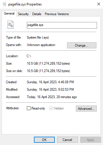

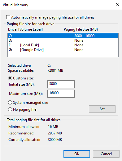

    Thank you all for your replies! I'm slowly working through each step but I have a few questions: @Samuria Is there a particular malware scan you would recommend? Is Malwarebytes okay? @zbook When I looked up how to move the pagefile it led me to this (this was before I started tinkering with it):
    Frequent BSoD because of one time overheating? 389177d1681642411t-increasingly-frequent-bsods-stop-codes-change-each-time-pagefile-before.png
    Am I understanding correctly that this means the pagefile was already on C:? I was also able to locate the actual file on C: but could not find the same on D:
    Frequent BSoD because of one time overheating? 178d1681645152t-increasingly-frequent-bsods-stop-codes-change-each-time-pagefile-c-drive-before-.png
    Anyhow I have changed it so it looks like this now (I wasn't sure how big to make it):
    Frequent BSoD because of one time overheating? 389179d1681645310t-increasingly-frequent-bsods-stop-codes-change-each-time-pagefile-after.png
    Is this correct? Should I change the sizes? And for step 5), just to clarify is this asking me to reinstall Windows completely? Sorry I'm not sure what exactly "install to desktop" means, I'm reluctant to wipe Windows completely at this point but I can if you think it's required. Here are the links for step 3): Tuneup.log - Google Drive RAM_info.txt - Google Drive @ubuysa My apologies, I was under the impression that Windows automatically searches and updates these drivers for me. I'll go ahead and update all the ones you've linked now! I already updated the nvidia drivers when I reinstalled with DDU last night, but a BSOD did happen when I initially tried to reinstall after uninstalling, would it be worth doing this again? This is the currently installed version:
    Frequent BSoD because of one time overheating? 1681647339t-increasingly-frequent-bsods-stop-codes-change-each-time-screenshot-2023-04-16-221505.png

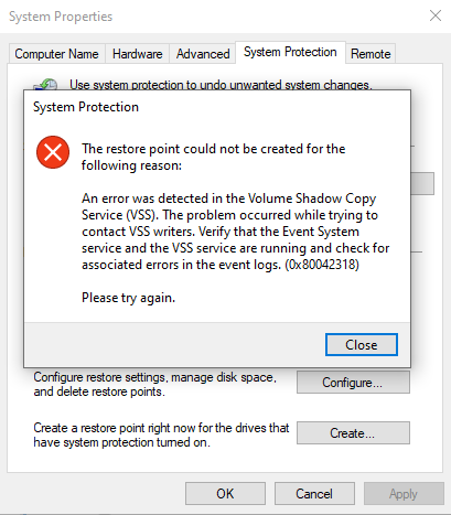

    Also when you say "The tcpip.sys and NETIO.sys drivers are Windows drivers (so not at fault)" and "The kbdclass.sys is a Windows keyboard class driver, so it's not at fault", what do you mean by it's not at fault? I will try to run Memtest86 tonight. Also should I keep uploading new minidump files as they happen? Thank you everyone!! Update: I just checked the pagefile settings again after restarting my PC and it seems to have reverted back to its previous size (10gb) and state (system managed)... Is this normal? Update 2: I just tried to create a system restore point for step 4) and it gave me this:
    Frequent BSoD because of one time overheating? 186d1681650625t-increasingly-frequent-bsods-stop-codes-change-each-time-system-restore-vss-error.png
    I don't know what this means... but I have seen this VSS thing before in Event Viewer as I mentioned in my first post
