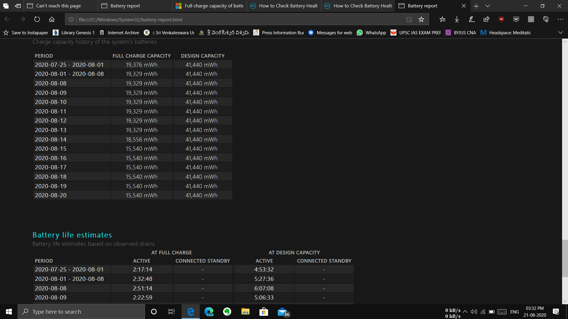

  1. Full charge capacity is decreasing very rapidly. Help!
    since the last 30 days my battery is not holding the power well. Hence, I went on to generate battery report which is shocking that the full charge capacity is degrading very very rapidly.
    Things i noted:
    1 Degrade occurs when it goes below 15% that too when it hibernates/sleeps
    2 Sometimes Battery indicator show 100% full then upon unplugging it immediately goes to 93%
    3 Sometimes when it reaches 20% it immediately goes to 6% and hibernates
    My effort in conserving battery:
    1 Brightness always below 25%
    2 power plan - better battery mode always
    3 No battery hungry softwares and games
    4 Never let it die completely to 0%
    5 No unnecessary peripherals
    My worst battery practices:
    - Will full charge daily upto 100% sometimes twice a day realized only now
    Device:
    Dell Vostro 15 3578 more - https://www.flipkart.com/dell-vostro-15-3000-core-i5-8th-gen-8-gb-1-tb-hdd-windows-10-home-2-gb-graphics-vos-3578-laptop/p/itmf4daagnkjbzmx?pid=COMF4DAAMPFUWFHZ&lid=LSTCOMF4DAAMPFUWFHZCD6VRP
    OS- Win 10 2004
    Age : 20 month old
    Avg. use: 6 to 7 hrs /day
    type of use: No gaming, only for work & study purposes
    current battery status - 12669 mWh left out of 41,440 mWh
    know that batteries usually wear off and die eventually but I dont think my lap is that old and also these things regarding battery are happening now of late.
    Any help appreciated!
    Full charge capacity is decreasing very rapidly. Help! 3b3959e3-82d9-4989-8069-4ec2e9853655?upload=true.png
    venkatesham7, Aug 21, 2020

    Battery FULL CHARGE CAPACITY Reset
    Yves,
    "Full charge capacity" means the capacity that the battery is managing to achieve. It is not a limit set by Windows or anything else; it is merely a reading of what the battery can actually do. You can use the comparison of Full charge capacity with Design
    capacity to decide when to buy a replacement battery [I do the same regularly].
    Full charge capacity will always decrease over time as the battery wears out. This is a chemical phenomenon not a Windows-imposed characteristic.
    Windows display of "Fully charged [100%]" means - the battery is currently at 100% of what it is able to achieve. In other words, "Fully charged [100%]" is relative to Full charge capacity.
    Sometimes, you can find that cycling through the battery three times** can improve the Full charge capacity a bit.
    On at least one of my batteries, the maker recommends doing this every three months. But doing so is using up even more of its remaining life so you can complete this procedure only to find that you are worse off afterwards.
    ** In other words, loop through this three times -
    • remove the AC power
    • use up the whole charge by using the computer
    • recharge fully
    Denis
