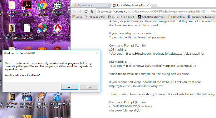

    hi slartybart
    thanks again so much for working with me.
    ok. i have completed step 1. and the text notepad is attached. 2nd. Photo gallery is an organizer and all my photos has been backed up to an external drive, if i missed anything it won't bother me much as long as this problem is fixed. 3rd. Iwl new search results 0522.txt didn't have wlarp so i downloaded the one you attached and received this error upon installing which is also attached. Based on these previous steps i didn't go any further as to not create more problems.

    Gallery Button Missing 81431d1485967374t-photo-gallery-missing-files-wl-essential-2011-setup.jpg
    stressful1, Dec 11, 2023

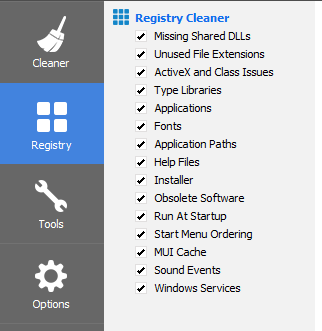

    download cCleaner (free)
    install - remove the checkboxes from any extra software offered (Google Chrome for example)
    Run cCleaner
    Select Registry
    Select all entry types
    Gallery Button Missing 80776d1485967239t-photo-gallery-missing-files-ccleaner-0.png
    Press the Scan for issues button
    Select all in the scan results panel
    Press the fix selected issues... button

    There's one question I have left
    Where are those PhotoGallery and Mail folders I see in your search results. They're not Windows Live, just the names
    If they're in an xxx Apps folder, then they're most likely a Windows Universal Platform (WUP) app, not Windows Live applets
    Post another search (details view, sort by name) - that would help.
    If you're sure that all Windows Live folders are renamed - you can go ahead without waiting for me to confirm - you seem competent *Wink
    The next step is to install Windows Live Photogallery from the offline installer (post# 2) - choose PhotoGallery only for now
    Net 3.5 is required for Windows Live - the installer should ask and offer to download. You can also get it in Programs and Features > turn Windows features on > Select Net 3.5 (sb at the top)
