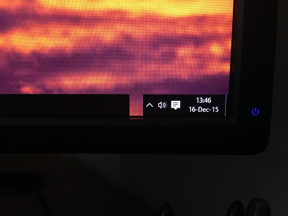

  2. toastboy Win User
    Gap in Taskbar?
    Gap underneath taskbar after windows quality update 53960d1485960842t-gap-taskbar-img_0671.jpg
    It usually takes a little while, but at some point this little gap in the taskbar appears and the only way I've ever managed to get rid of it is doing a full reinstall of Windows. Then its usually gone for little while (weeks to months) but then will come back again. Sometimes its not a gap and its a second arrow, but one that cannot be clicked.
    Any ideas? I've done an SFC and disabled some of the programs that load on startup. No change. Sometimes restarting explorer.exe works, and sometimes it doesn't.
    Its there as soon as the desktop appears.
    This is an issue I also had in Windows 7 before I upgraded to Windows 10 (clean install)
    toastboy, May 5, 2023

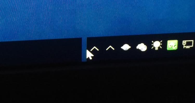

  3. Gap in Taskbar?
    I have exactly the same issue. Win 10 home 64bit. using the stock theme

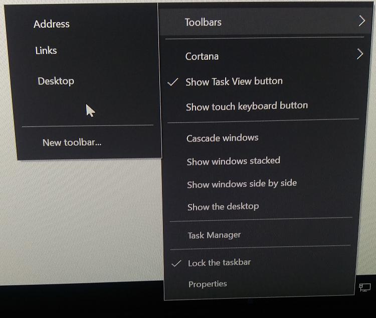

    Gap underneath taskbar after windows quality update 60749d1485962379t-gap-taskbar-imag0055-2-.jpg
    I have no idea how to fix what causes it but I managed to figure out that its an un-named toolbar. if you right click on your taskbar and go to toolbars you will see a blank line under desktop as per this photo.
    Gap underneath taskbar after windows quality update 60748d1485962379t-gap-taskbar-imag0054-2-.jpg
    click this blank line and the gap will disappear. it will come back again at some point, I don't know how or why but this is easier than a reinstall.
    Hope this helps and someone more knowledgeable than me can find a root cause for it.
