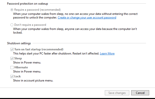

  5. Windows 10 -How to enabled greyed out shutdown options
    After upgrading from Windows 7 to Windows 10 my hibernate option from Shutdown / Power removed. When check from "Choose what the power buttons do", the Shutdown settings was greyed out and I am not make hibernate enable.
    Add Enable forced button/lid shutdown to Power Options in Windows 747d5316-b996-47da-894c-3e0582df1497.png
    Please suggest how to enable Hibernate in Power options.
    Thanks & Regards
    Ghazanfar
    GhazanfarShaikh, Oct 27, 2019
