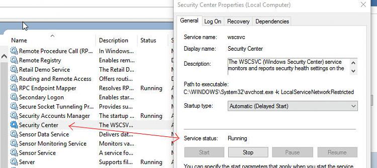

  3. JeffL Win User
    Error 0x80070426
    Fast Start on or off makes no difference.
    Software Protection is set to Automatic Delayed. The status on the list of services does not show it running. The status on the properties showed it running, then not running. If that sounds strange, look at the status of the Security Center on both windows, it's showing both:
    Getting Error 0x80070426 when I try to start XBox app on my PC 102250d1485972030t-error-0x80070426-screen2.jpg
    JeffL, Mar 8, 2024
