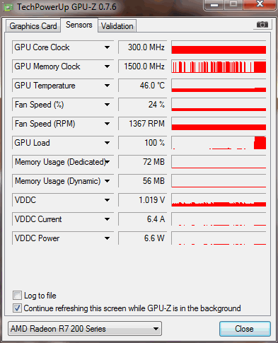

    I've followed very carefully all your steps. But here is the result: *Frown GPU Clock stuck at 300MHz :(
    This is when I run the test from GPU Z. *Frown GPU Clock stuck at 300MHz :(
    bigbanghuy, Mar 11, 2023
  3. R7 260X always runs at 2D Clock (300Mhz)
    First you should do a fullscreen benchmark to see if the clocks will go up. (Any windowed benchmark is never a good test for that).
    Like 3DMark 2013
    I would suggest you again in CCC -> Performance -> Overdrive
    • enable Overdrive,
    • then move the power slider to the right, in order to allow it sufficient power.
    • then -slightly- overclock the core using AMD's own Overdrive right there. 50 Mhz up should be enough.
    • Click Apply.
    Otherwise, I would suggest that you install the drivers you got with the card. (as they are older than 13.12 whql first completely clean from AMD drivers).
    Blín D'ñero, Mar 11, 2023
