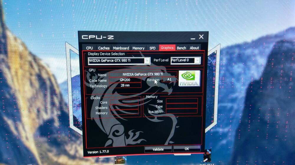

    Hello everyone I am having this weird problem on my computer and I am convinced it is a driver problem, let me explain. A couple days ago I made a post showing some weird red dots appearing on my screen, most
    users said the gpu is dying which I agreed to but one person suggested I use DDU to uninstall the drivers and reinstall them,
    one thing I wanna mention is my nvidia drivers where not fully up to date but not super old I like to stay on a driver if I see it is stable, but anyways before I used DDU I would get some blue screens but
    not very often just had the annoying red dots and no applications could see my gpu,
    once I used DDU this is what I said "I did It and now my PC blue screens every single time I turn it on" this is what I said a couple mins later "okay after several restarts and mini heart attacks it works
    again but as soon as I try and update the driver it black screens so this gpu is staying on I dont even know what driver its on"
    So with that being said I tried to update the driver but just kept crashing so had to force shutdown a couple times and then just left the updating driver thing alone. A few days later my computer is blue screening
    like crazy to the point where I cant even turn it on before it blue screen, but I discovered something I believe the blue screens are the cause of a dying gpu and badly installed drivers, because I usually boot from my m.2 but I used to have a ssd which was
    my previous boot drive,
    so I plugged it back in and booted into it and it worked! still had the red dots but this had me convinced it is a driver problem since the ssd has older properly installed nvidia drivers. I am gonna put some
    videos below so you guys can see.
    Anyways Im gonna use this post as kinda of a double question, I did order a new gpu only thing is its a AMD product so how would I be able to uninstall the drivers from my m.2 boot drive if I cant even get
    in? if I just plug in the amd gpu do you think it would just load in and work letting me uninstall nvidia drivers and install the amd ones?
    Turning on and trying to boot into the m.2 (that ugly noise is the rear exhaust fan btw) one more thing that blue screen I get is always the same one now back then it would change now its that one all the time
    Loading into ssd boot drive with older properly installed drivers
    Video showing from inside ssd boot drive if I lower screen res red dots go away
    GPU failing? every 1-2 weeks, worried it might be dying need help please! 7977e383-91ed-4f21-9b25-a8635c50f451?upload=true.jpg
    Sorry
    for the long post but I just want some more ideas and suggestions to what I can do in regard to uninstalling the drivers from the m.2 and installing amd ones if you guys even think thats the problem. Thanks everyone!
