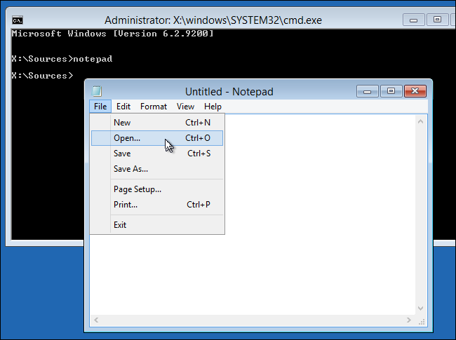

    Method 1: Backup data using Command prompt.
    1. Attach the Installation media
      (USB/DVD which has windows 10) into the computer.
    2. Restart your PC, and then press any key to boot from the USB flash drive or the DVD.
    3. Click on Repair your computer.
    4. Select Troubleshoot > Click on Advance options.
    5. Select Command Prompt from the list.
    6. Type: Notepad.exe
    7. This will open the Notepad > Go to File >Select, Open > this will open the Windows explorer window. Attach the External hard disk or backup media to back up your files.
    8. Click on This PC > Select the C drive (C is the drive, where Windows is installed).
    9. Open Users folder > Open the Username folder and check if you can find the files or your data.
    10. Now, right click on the folders > Select Move to and choose the destination as your External Hard Disk.
    11. You will not see a progress bar, the time depends on the amount of data to be copied. After sometime, plug out the External hard disk, connect it in the different computer and check if you have all the required
      files.

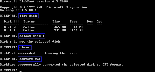

    Method 2: Convert from MBR to GPT.
    Follow the same steps (From 1-5) as above to open the command prompt using Installation media.
    1. In the command prompt, type:
      DISKPART
    2. Then, type: List Disk (Note down the disk which you want to convert to GPT)
    3. Then, type: Select Disk DiskNumber (Disk number is the disk which is listed in the above command, Ex:
      Select disk 0)
    4. Now, type: Clean
    5. Then, type: Convert GPT
    6. Lastly, type: Exit
    Hard Disk Corrupted - install Window without data loss 18eb1534-0413-4cfd-a15c-5393275caae0?upload=true.gif
    Now, start the Windows installation to install it in GPT format. If you are facing issues with UNMOUNTABLE_BOOT_DEVICE, I would suggest you to follow the Microsoft article on
    Bug Check 0xED: UNMOUNTABLE_BOOT_VOLUME.
    Hope it helps.
