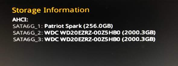

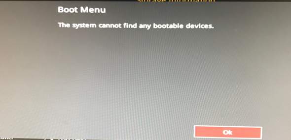

    after I made it with my computer system into the Bios there is the following problem.
    In the storage information all my hard drives (SSD 256GB 1x with win10, HDD 2TB 2x for storage) will be recognized, I have the following problem that I can not boot from my SSD or what it is not even shown in the boot options.
    I went through all the BOIS settings and checked the wiring and the boards for damage, but in no case was there a problem.

  2. hard disk is being detected but not appearing in boot order
    check in BIOS if you can set the hard disk priority to primary; if you don't have that option, check the hard disk configuration if you can access it for anything unusual.
    if you can boot from the WIN CD, but it can't find any windows operating system installed, it's possible the boot partition of the hard disk was corrupted;
    you might want to also consider reseting CMOS and loading default BIOS configuration - you can do this by turning all power off, and turning off the switch on the power supply (or unplugging the computer), then remove the CMOS battery on the motherboard. Wait 15min (1 hour if you really want to be sure), reinstall the battery, and power everything back on. BIOS will then load default values and have to redetect your hardware.
    imperialreign, Jun 22, 2020
