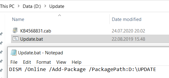

  4. Pauli O Win User
    Hardware compatablity hold issue Version 20H2 Build 19042.630
    Can't upgrade Windows 10 build 19042.330 to 19042.421: not supported directory or lower version
    Do you have download some unofficial ISO? Your issue is caused by how 20H2 preview is made.
    When you turn your PC to Beta Channel to get 20H2 preview only small CU, KB4562830, (20H2 Enablement package) is used to change build number from 19041 to 19042 and version number to 20H2. Setup files on your 20H2 ISO's are still basically build 19041. If
    you do clean install it will automatic inject that KB and eventually you get 19042.421 installed.
    BUT: If you try in-place update with ISO then update program see installed build as 19042 and can't keep old apps and files. It's not possible to downgrade version / build numbers.
    Why don't you use Windows Update?
    It's possible to update from .388 to .421 manually, but you have to find latest KB4568831 from somewhere. When you have that KB make some folder, save it there with small script.
    On my case I have D:\Update with that KB and script Update.bat.
    Open CMD as Admin go to that directory and run Update.bat
    Hardware compatablity hold issue Version 20H2 Build 19042.630 535fec99-34e6-43bd-aaf8-923b1a639c15?upload=true.png
    Pauli O, Nov 18, 2020
