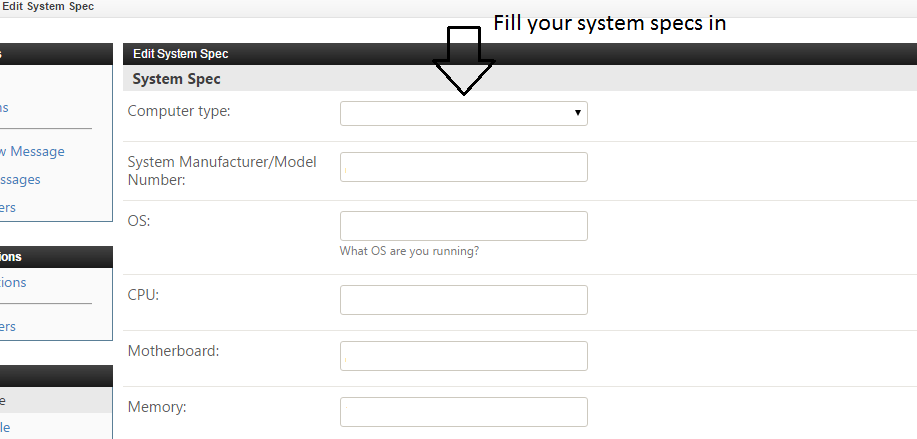

    Please fill in your system specsPlease go to this site and download the tool. The tool will give you detailed information about your system specs, please fill in your system specs more completely.How to fill in your system specs:
