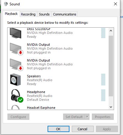

    when I plug in my headphones in my pc my headphones driver doesnt show anymore and now i cant hear any audio. This all happened right after I got a new case for my pc which was today. This is a picture of my headphones driver showing up yesterday before I got a new new case in Control pane:>Hardware and sound>Sound. headphone driver doesnt appear. 70002162-083f-423c-848d-4aa6eec186cd?upload=true.jpg

    I understand that the headphones are not working when you connect then through the jack on your Windows 10 operating system. I will certainly help you with the query. I would appreciate if you could help us with more information
    • Have you checked plugging the headphone to a different jack on the same computer?
    • Have you checked if any other sound device work fine when plugged to the problematic jack?
    This issue might be occurring due to incompatible drivers or broken jack. There might be a possibility that the headphone is not compatible with windows 10 operating system. Hence I would suggest you to follow the below mentioned
    steps and check if that helps.
    Method 1:
    Hardware and devices troubleshooter
    The built-in hardware and devices troubleshooter can automatically detect and fix most of the incorrect settings and errors that could cause issues with hardware. I would suggest you to run this troubleshooter to check if there is any issue with
    the display adapter. Refer top these steps:
    • Open Control Panel
    • Click on Troubleshooting and select the view all option on the left pane.
    • Click on Hardware and devices troubleshooter and follow the prompts.
    Try method 2, if the issue persist
    Method 2: If the Hardware and Devices troubleshooter do not fix
    the issue then I would suggest you to uninstall the drivers and reboot the computer to get the updated drivers installed for the headphone. Please follow below mentioned steps:
    • Click on Device Manager and select the audio input and output drivers
    • Right click on driver that appears after plugging the headphone and click on uninstall
    • After uninstalling, unplug the headphone and restart the computer
    • Plugging the headphone again and the computer will detect the updates drivers automatically.
    Now check if the headphones work on the computer or not.
    Hope this information is helpful. Please write back to us if you need any further assistance, we'll be glad to assist you.
