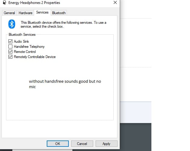

    BT headphone no mic on win10pro
    hello, I've tried to use BT headphone on windows10. But when speaker works mic stops. when mic works speaker stops.
    There is two options in my sounds settings stereo and handsfree. Stereo has no mic option. Handsfree has but bad sounds quality on speaker. I want to use mic with good speaker.
    What did I tried to solve
    1- Reset all BT services
    2- uncheck Handsfree on headphones preficens
    3- Set manually speaker and microphone devices
    none of it works..
    Any thoughts?
    Headphone option not showing and headphone mic not working 275187d1587225793t-bt-headphone-no-mic-win10pro-e.png
    Headphone option not showing and headphone mic not working 275188d1587225793t-bt-headphone-no-mic-win10pro-d.png
    Headphone option not showing and headphone mic not working 275189d1587225793t-bt-headphone-no-mic-win10pro-c.png
    Headphone option not showing and headphone mic not working 275190d1587225793t-bt-headphone-no-mic-win10pro-b.png
    Headphone option not showing and headphone mic not working 275191d1587225793t-bt-headphone-no-mic-win10pro-.png
    Headphone option not showing and headphone mic not working 275192d1587225817t-bt-headphone-no-mic-win10pro-g.jpg
    Headphone option not showing and headphone mic not working 275193d1587225817t-bt-headphone-no-mic-win10pro-f.png
