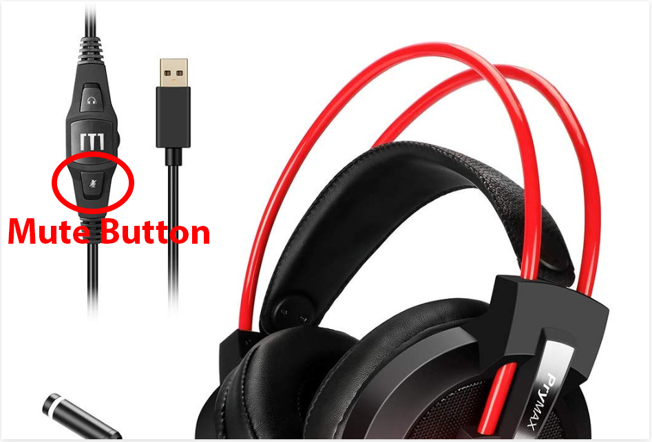

    I have three different brands of USB Headsets with Microphone and Mute Button Wired and Wireless all with the same behavior as follows:

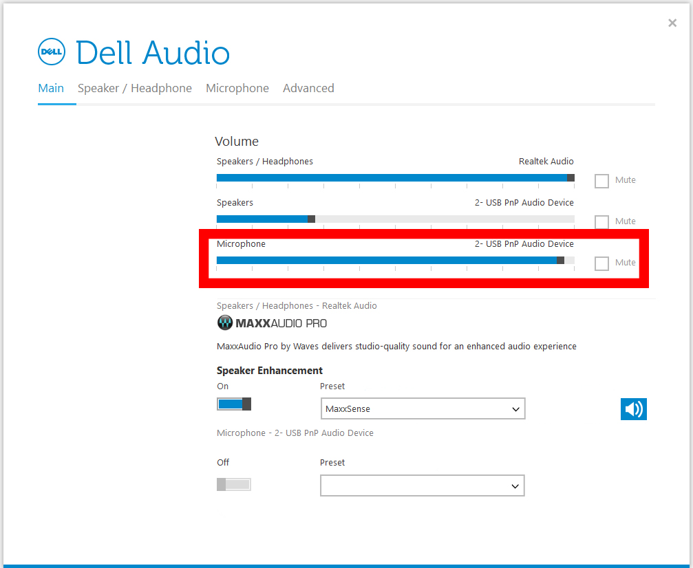

    1. If the Mute checkbox shown below is UNCHECKED and the microphone's mute button on the headset is toggled on and off the microphone is muted by the headset's microphone internal circuitry which does successfully mute the sound to the record capture,
      however it does not update the mute checkbox in system settings for the USB microphone device.
    2. If the Mute checkbox shown below is CHECKED then the Headset's Microphone Mute button has no effect what so ever.

    I have a couple of gaming headsets both with a mute button. If I go into Windows 10 Sound Manager I can see the headset speakers and microphone and all have a mute checkbox.
    I have written a program in C++ that allows me to mute or un-mute the microphone as seen in the Sound Manager and the checkbox is turned on and off successfully coinciding with my C++ program settings.
    This setting is overriding the Mute button on the headset and I can see no way to detect the user muting the microphone via the headset's mute button. I am trying to incorporate into an application for the
