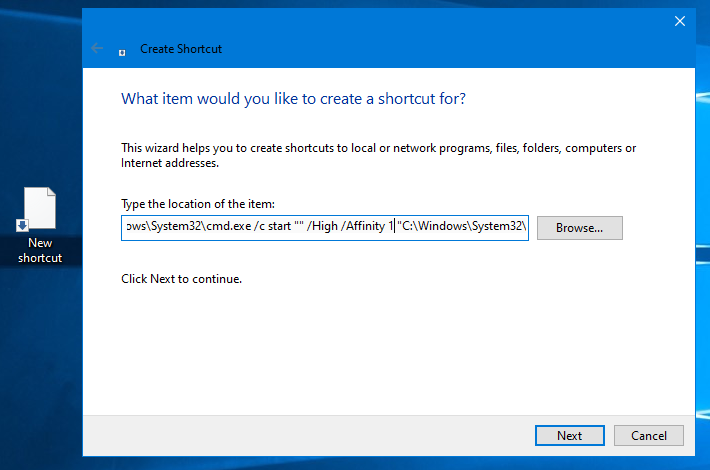

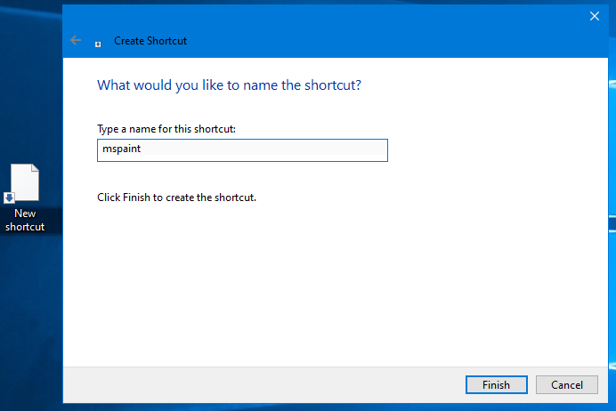

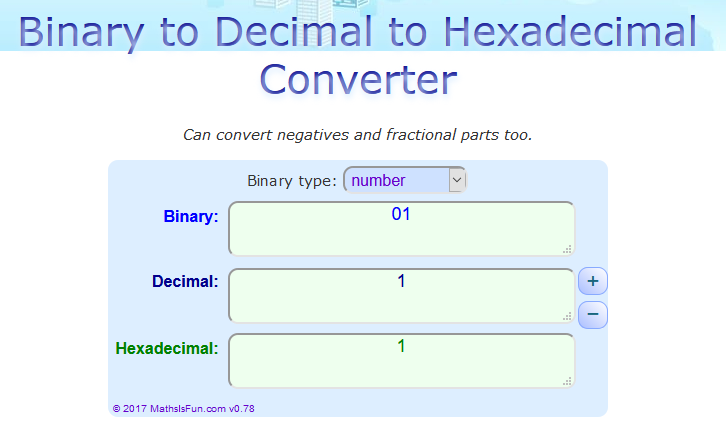

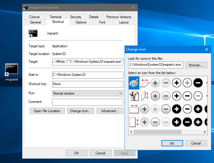

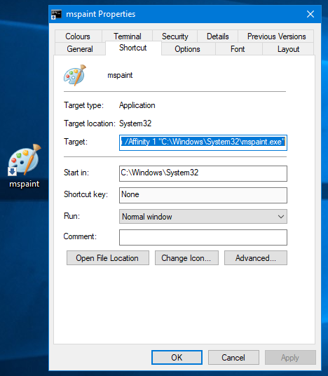

    I use batch scripts to set the affinity and priority.
    Hello,everytime i try to set my affinity of a game on high i get "No Permission" error on... 255864d1574150477t-how-permanently-set-cpu-affinity-programs-screenshot-191119003-.png
    Binary/Decimal/Hexadecimal Converter
    Code:
    You can also create a shortcut on the Desktop:
    Code:
    Hello,everytime i try to set my affinity of a game on high i get "No Permission" error on... 255873d1574152426t-how-permanently-set-cpu-affinity-programs-screenshot-191119012-.png
    Hello,everytime i try to set my affinity of a game on high i get "No Permission" error on... 255872d1574152426t-how-permanently-set-cpu-affinity-programs-screenshot-191119013-.png
    Hello,everytime i try to set my affinity of a game on high i get "No Permission" error on... 255871d1574152426t-how-permanently-set-cpu-affinity-programs-screenshot-191119014-.png
    Hello,everytime i try to set my affinity of a game on high i get "No Permission" error on... 255870d1574152426t-how-permanently-set-cpu-affinity-programs-screenshot-191119015-.png
