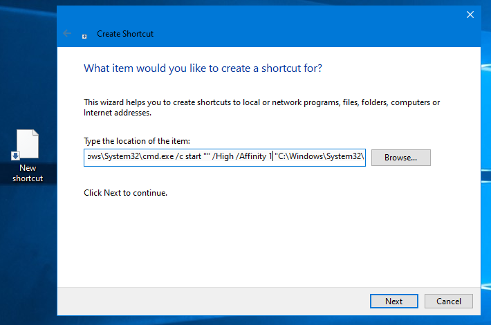

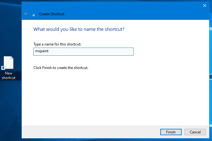

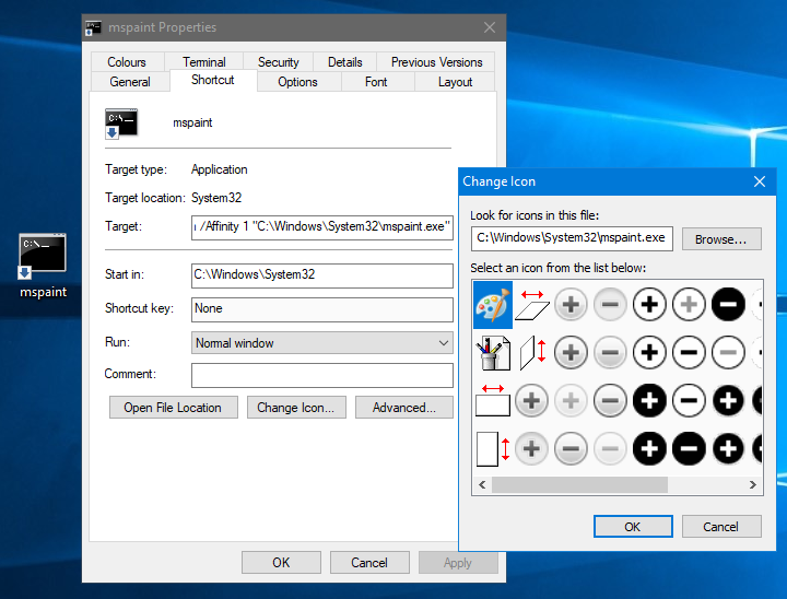

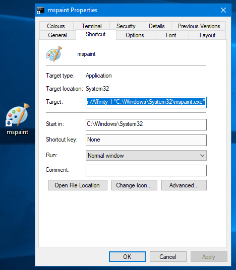

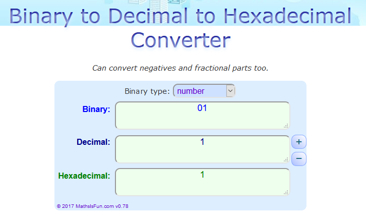

  3. Polo6RGTI Win User
    How to permanently set cpu affinity for programs?
    I use batch scripts to set the affinity and priority.
    Hello,everytime i try to set my affinity of a game on high i get "No Permission" error on... 255864d1574150477t-how-permanently-set-cpu-affinity-programs-screenshot-191119003-.png
    Binary/Decimal/Hexadecimal Converter
    Code:
    You can also create a shortcut on the Desktop:
    Code:
    Hello,everytime i try to set my affinity of a game on high i get "No Permission" error on... 255873d1574152426t-how-permanently-set-cpu-affinity-programs-screenshot-191119012-.png
