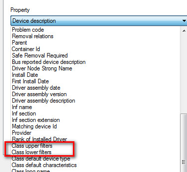

  3. X99 USB Problems? What is it and how can i fix it? Code 43
    A few more things you can try....
    • Check if a driver filter is applied to usb 3 controllers (i;ve only seen filters on a usb controller in one case but worth checking)
      • Right click the 3.x controller->Properties->Details tab. Use pull down menu and look to see if Class upper filter or Class lower filter is listed. Report what you find
    • Google usb disable selective suspend. Follow instructions to turn if off on your controllers
    • Run UsbTreeView . You can see how your devices connect back to and which controller. Disable one usb 3.x controller and test. Then enable it and disable other. See if you get same problem with each controller or maybe it's just local to one
    Hello, I have a problem with code 24 in defining this controller hôte AMD USB 3.10... 133698d1485965894t-x99-usb-problems-what-how-can-i-fix-code-43-a-filters.jpg
    ComputerGeek, Aug 8, 2023
