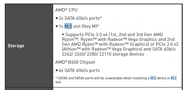

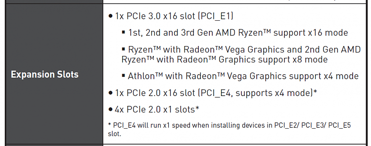

    No Boot, Drives Not detected, Can't Load Win10 Pleses Help!
    From Page 16 of the downloadable English manual:
    Hello, my PC continues to Blue Screen and I'm trying to fix it. Plese help. 264917d1580253185t-no-boot-drives-not-detected-cant-load-win10-pleses-help-m.2.b450.png
    The blue highlighting is from a text search. I don't see anything about additional competition for PCI-E lanes, except:
    Hello, my PC continues to Blue Screen and I'm trying to fix it. Plese help. 264918d1580253416t-no-boot-drives-not-detected-cant-load-win10-pleses-help-pcie.png
    These may not give the full story.
    bobkn, Jan 28, 2025
  4. topgundcp Win User
    Until the BIOS sees your M.2, there's nothing you can do. It does not matter if the M.2 is unformatted/unallocated, the BIOS should see it.
    1. Suggest that you take the M.2 out, clean all the contacts and re-seat it and hope this is the case.
    2. If step one fails. Connect your 250GB SSD back in using one of the SATA port to see if the BIOS recognize it. If it doen't, then it might be something wrong with the MB, if it does then boot up the Windows Installation USB, run diskpart, shrink it at least 40GB then create a partition, Leave it unallocated then install Windows there.
    Also try to re-seat all other components such as Memory, Video card etc...
    topgundcp, Jan 28, 2025
