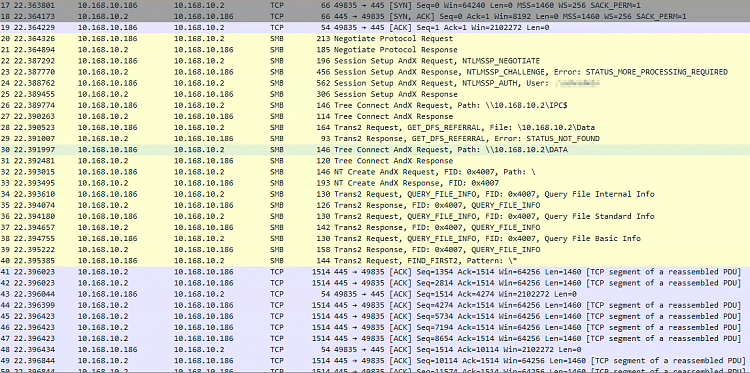

    Hey all, dealing with a really stubborn problem in an office environment. I have one workstation running Windows 10 21H2 (10.168.10.186) that refuses to automatically reconnect its mapped U: drive to a folder shared off of a virtual Server 2008 R2 instance (10.168.10.2) after rebooting. This is annoying because the employee uses a program that requires this drive to be mapped and accessible to operate. I am able to click on the mapped drive in File Explorer to re-establish the connection but this is irksome and I'd like to get it fixed. This particular office is NOT on a domain (the workstation and the server are on the same workgroup), and this is the only computer in the office for which this happens. To describe the process:

    Here is the start of a Wireshark capture I performed after clicking on the mapped drive to re-establish its connection:
    Help me! sometimes connect to mapped drive from windows server, then my computer stop... 69t-windows-10-computer-will-not-automatically-reconnect-mapped-drive-2022-07-29-15_23_56-window.png
    Any help at this point would be appreciated. I suspect the fact that the server instance is 2008 R2 might have something to do with it, well maybe anyway. EDIT: Almost forgot. For reasons that are unknown to me, the server actually has a mapped drive on it pointing to the same resource, i.e. a mapped drive pointing to itself. And this mapped drive is ALSO broken unless it is clicked on. Pretty weird. EDIT 2: Performed a test where I created a shortcut on the workstation desktop to a file located on the server share. When I clicked the shortcut the file opened without issue. I then opened the aforementioned application and it worked without a problem.
