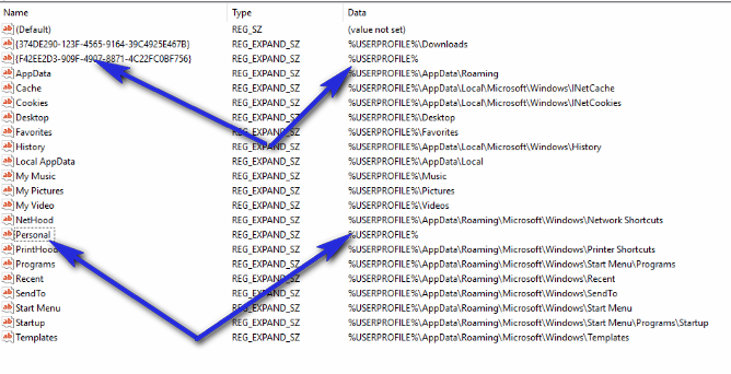

  2. Adalo_22 Win User
    Accidentally merged User and Documents folders
    I was moving some files around on my hard drive and I accidentally merged my User folder with my Documents folder. So in my C:\User directory instead of seeing C:\Users\MyName I see C:\Users\Documents. Seen below:
    HELP! Was moving around and accidentally merged user folder and documents folder 915ae32b-3849-4b55-b9ff-d1b6369f0eed?upload=true.png
    I have looked through a few different forums on how to fix my mistake, but I am not 100% sure on how to fix it. I believe that I need to make a change in the registry because the data field for "Personal" is %USERPROFILE% and not %USERPROFILE%\Documents.
    Can anyone help me with some steps that I can follow so I can resolve my mistake? I don't want to mess up the registry and hurt my machine. Thanks in advance!
    Adalo_22, Jan 1, 2022
  3. DaveM121 Win User
    Hi Adalo_22
    Yes you are correct, that is merged, open the Registry Editor, it should still be on the same page
    Double click Personal and set its value data to:
    Also, double click the DWORD at the top indicated in the image below and set that to the same value and set its value data to the same value
    When that completes, close the Registry Editor and restart your PC
    That will reset the location of that library folder
    You may need to manually move files and folders from your users folder back into Documents
    Please Note, the icon on your Documents folder may not change immediately, but it will, it just takes Explorer a while to catch up on changes made in the registry . . .
    HELP! Was moving around and accidentally merged user folder and documents folder e6d4bd50-e995-4f8e-969c-a00b5a364d8c?upload=true.png
    DaveM121, Jan 1, 2022
