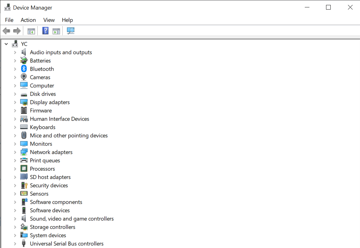

  1. Here is an unknown device but no biometric device but my notebook has a fingerprint sensor,...
    Screen captured
    MuzzammilTharia, May 18, 2021

    I understand your inconvenience. We will assist you to resolve this issue.
    I suggest you to follow the methods provided below and check if it helps.
    Method 1: Enable Biometric option.
    I suggest you to enable the Biometrics to pick up the Biometrics setting. This option shall be enable by default. However, I recommend you to follow the steps provided below and check if it enable or not.
    • Press Windows logo key + R key.
    • Type gpedit.msc and press
      Enter
      key.
    • Under Computer Configuration, navigate to.
    Administrative Templates Windows Components Biometrics
    In the left hand panel of the Windows, double click on the following:
    • Allow the use of biometrics
    • Allow users to log on using biometrics
    Select enable option and click on Apply and
    OK button.
    Now, restart your computer and follow the instructions provided below.
    After restarting the computer, I suggest you to disconnect and reconnect the fingerprint sensor device and check if the drivers are getting detected in Device Manager. If the issue still persist, follow method 2.
    Method 2: Reinstall drivers and compatibility mode.
    I suggest you to download and install the latest drives for fingerprint sensor device from the manufacture’s website and check if it gets detected.
    If the issue still persist, you may also install the drivers in compatibility mode and check.
    Follow the steps to install the drivers in compatibility mode.
    • Download the drivers from the manufacturer’s website.
    • Right-click on the installer and click on "Properties".
    • Click on the ‘compatibility’ tab and check the box "Run this program in compatibility mode for” and select previous Operating System from the drop down.
    • Click on ‘Apply’ and click ‘OK’ and run the file to install it.
    After installing the drivers in compatibility mode, follow the method 3 and check if you are able to get the sign in option with Biometric.
    Method 3:
    • Press Windows logo key + I key.
    • Click on Accounts.
    • Go to Sign in options.
    • The fingerprint option will always be visible if there is a WBF-supported fingerprint reader (and its associated driver) installed on the computer.
    For more information, refer the following Microsoft help article.
    Biometric Devices
    Biometric Devices (Windows Drivers)
    Hope it helps. Do let us know if your issue is resolved. For any further query, feel free to contact us.

  4. Here is an unknown device but no biometric device but my notebook has a fingerprint sensor,...
    unable to find fingerprint sensor in device manager and windows hello doesnt work anymore
    there is no unknown device or any biometric device but my notebook has a fingerprint sensor, it worked fine for a year or so but since the past year i have been trying to make it work.
    My model is HP pavilion x360 14CD0053TX
    Here is an unknown device but no biometric device but my notebook has a fingerprint sensor,... cab08f62-3512-4030-ad56-d12cbe3f7b79?upload=true.png
    yashchandna, May 18, 2021
