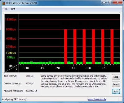

    There are two utilities you might be able to use to identify your problem
    and check the DPC
    DPC Latency Checker
    This older utility still mostly works on Windows 10.
    DPC stands for Deferred Procedure Call and is related to system interrupts.
    When the interrupt handler needs to defer a lower priority task until later,
    it calls DPC.
    DPC Latency Checker was designed to analyze whether your system can properly
    handle real-time audio or video streaming by checking the latency of
    kernel-mode device drivers, but it also reveals issues.
    This tool requires no installation. Launch it and let it work.
    If it shows red bars, this means that you have too high DPC counts.

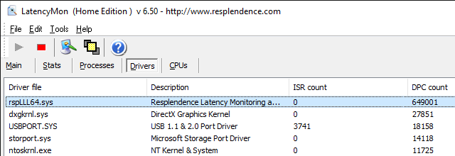

    LatencyMon
    This a latency monitor that can count DPC per driver.
    To find the driver with the highest DPC count, download, install and launch
    LatencyMon.
    Press the Start/Play button (green arrow), wait some time, then switch to the
    Drivers tab, and click twice on the DPC column to sort the driver files by
    DPC count in descending order.
    Drivers with a high DPC count potentially cause a high number of interruptions.
    This might look like this:
    Ignore the first item, which is the tool itself.
    You should then examine the other high entries.
    You may google for the Driver File name to find out what device it serves.
