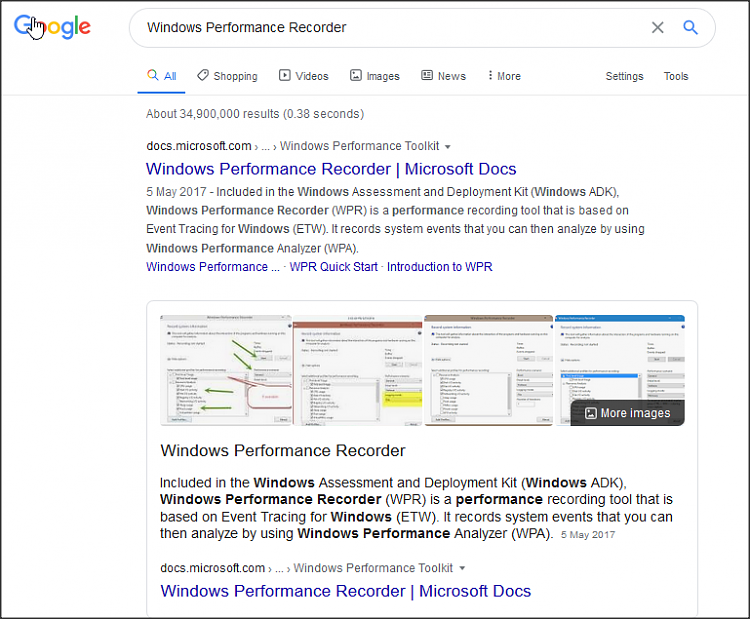

    One approach is to simplify hardware as much as possible, another to use a somewhat daunting tool from MS, the Windows Performance Recorder (tutorial available).
    High Latency, sound corruption and pops after watching audio - video. Problem still not solved. 287850d1594625631t-audio-video-tearing-high-dpc-latency-latencymon-1.png
    Similarly if you search tenforums for references to this you will see some example screenshots.

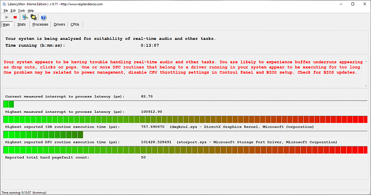

    I'm having some audio and video issues. They're most prevalent while playing games (Warhammer 2 and ESO, mainly) and the issues cause the games to stutter, drop FPS, and the audio becomes corrupted. This also occurs when starting the PC. The audio is corrupted and the mouse cursor jumps a bit.
    I'm not sure what I need to post for you to investigate these issues, but let me know and I'll do it.
    I noticed, however, dxgkrnl.sys and storport.sys have extraordinarily high DPC latency in LatencyMon.
    This is what I've done so far to fix these issues:
    * sfc/scannow
    * healthcheck
    * updated my audio driver
    * used DDU in safemode and updated my GPU driver
    * updated my chipset
    * reset my pc
    The following is what I see in LatencyMon. The spikes happen randomly and result in the torn audio and video issues.
    High Latency, sound corruption and pops after watching audio - video. Problem still not solved. 287810d1594599273t-audio-video-tearing-high-dpc-latency-latencymon-2020-07-12.png
    I'm lost and I have no idea what to do now. Thanks in advance.
